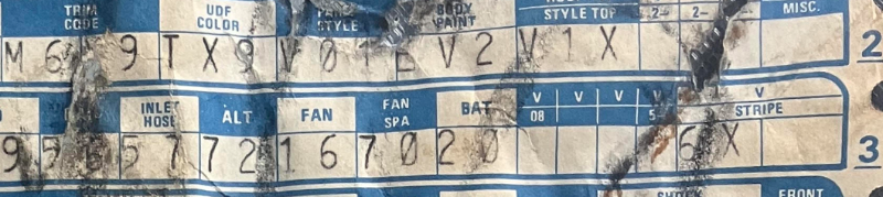

A31 package 7 blade torque drive fan stuff.
The pix shown uses a HYDEN THERMAL DRIVE FAN CLUTCH......fyi.....
BOB RENTON
No **** Bob, do you think I’m stupid? I asked the question because that’s the easiest way to differentiate between a thermal and viscous clutch…
It's a viscous clutch. So yeah, need the correct fan and clutch combo. Drats.
2863216 fan
2806070 clutch
