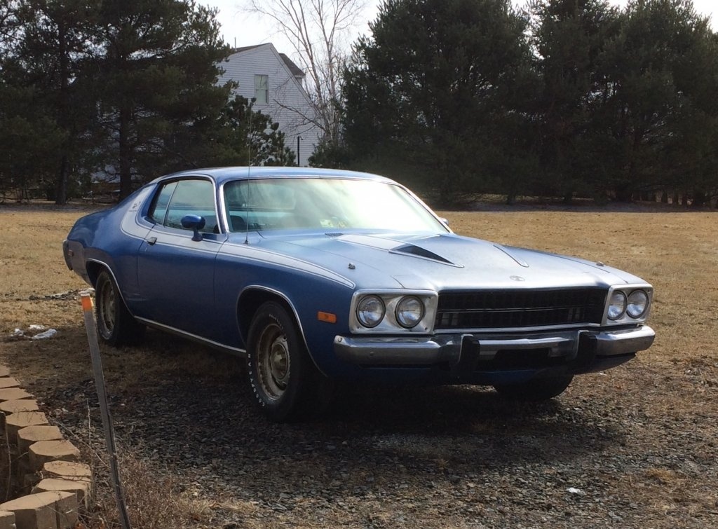

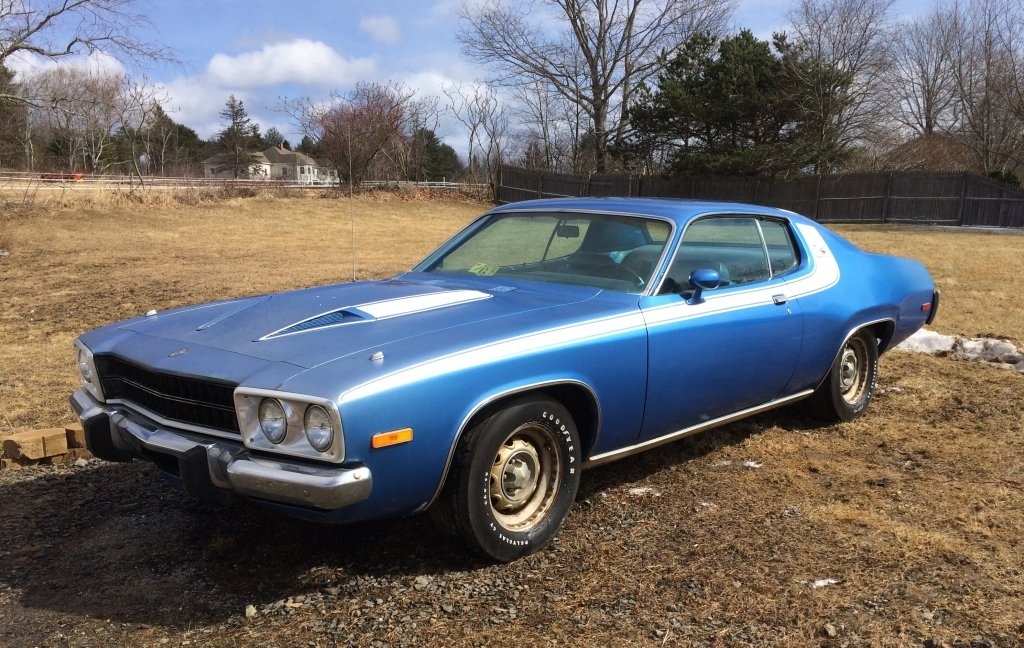

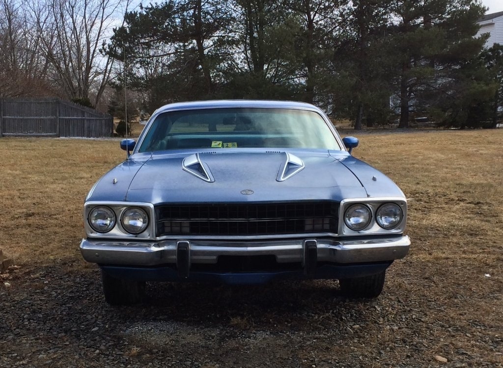

I have a 1973 Road Runner P-code 400ci 4bbl carb with automatic. I called it a 400 big block and a person got all over me. He said other than the 440ci, 1972 1/2 was the last year for big blocks. He said my 1973 400ci engine was considered a small block. Is he right?
Al in Maine
