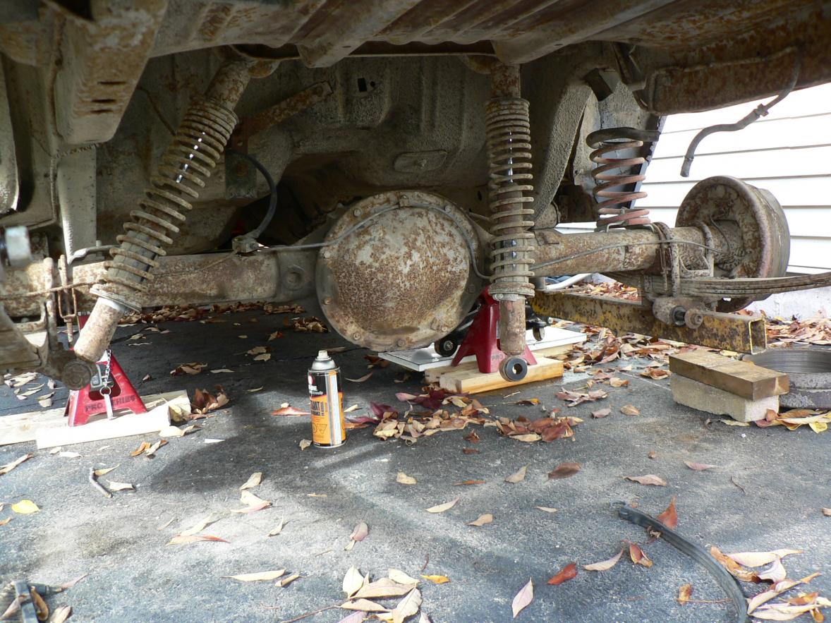

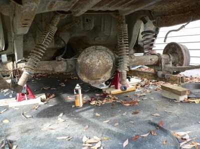

I need to clean it up, and want to get the right gasket for the rear cover leak
Thank you for any info
yep thats definitly a 8 1/4-
Whats nice is the brakes backing plates bolt right up to a 8 3/4 if you change up in the future

What grade and weight oil is it supposed to get?
Wow how many load bearing springs are on the back of that car? I see 2 leaf springs, 2 coil over springs, and some coil springs bolted to the top of the axle.
When I got her she had the extra long shackles on the back and even traction bars like they were compensating for somthing back in the 80's ;p

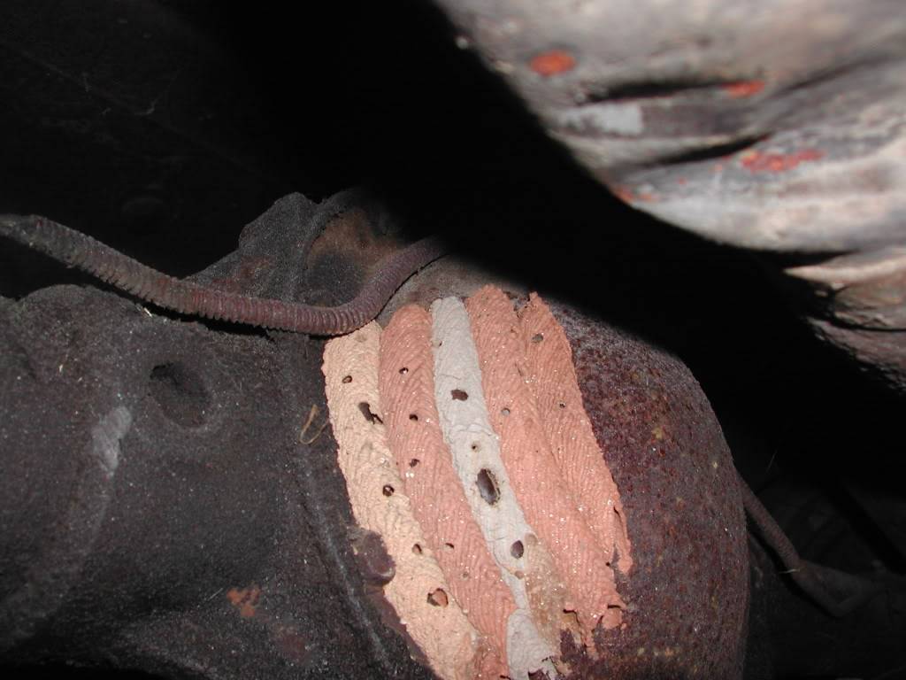

looks like mud bees to me..........aaaaaaaaaaaaaaaannnyhooooooooooo.....im not sure if thats a 8 1/4 or not
Cranky put this in for another member.. This will help identify...
