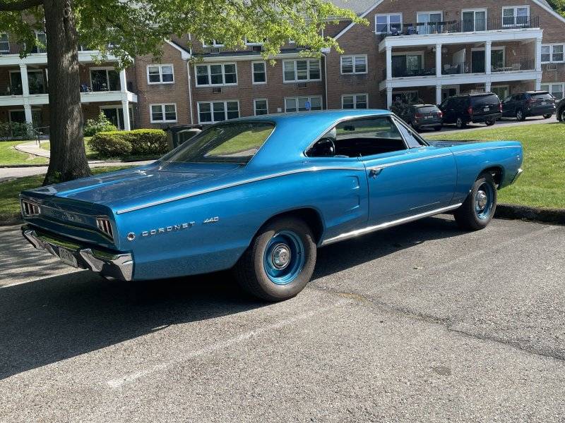

Is this 68 440 QQ1?
I recently learned this about the '68 color codes, the 1st letter - Q is the body color, the 2nd letter - Q is the roof color and the 3rd which is a digit - 1 means it is all 1 color. Of course this is on the steel, if there is a vinyl top that is not part of this number. A 2 tone car could be QW2, Blue/White 2 tone. I read this while trying to track down the QQ1 paint and found out that in '68 the code for the color is just the single letter Q and some paint cchip sheets will show that. Some will show QQ1. BMosley's spray out is acturate, Q & B5 & B7 are all different. Seems some paints the difference is not as big as this example and I've been to shows where you can't hardly tell, but if the 2 are parked side by side it is real easy to see.

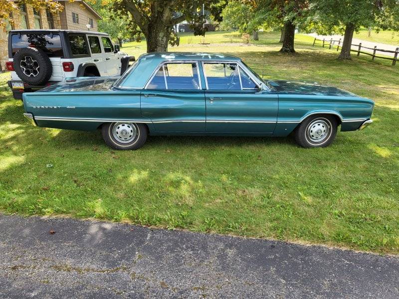

1968 QQ1.
That's nice. I'll be happy when I get my car to that point.
LOL, I'm now 65 and I had a QQ1 '68 RoadRunner when I was in high school and up untill I read about the color numbers recently I had always thought the entire number was the code for the Blue alone.
