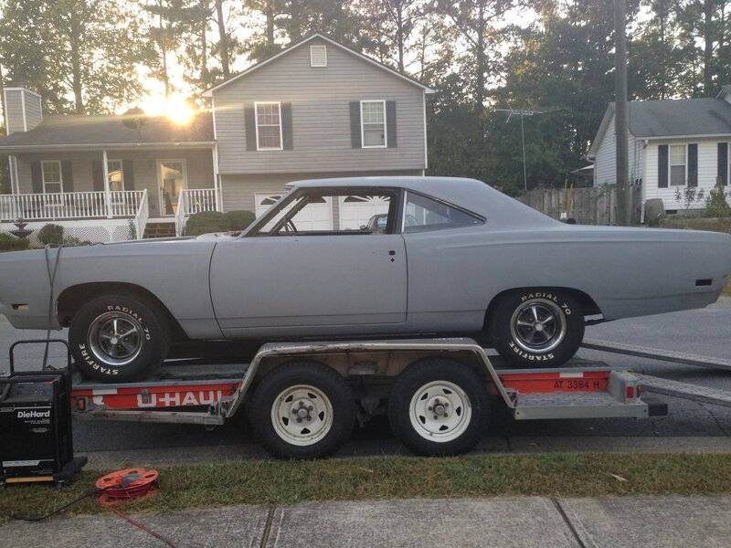

The Roadrunner in my sig was purchased for 8k. All bodywork was done except a small patch panel driver side rear lower quarter. Running and driving sort of. The engine ran and had some brakes.
The lower quarter patch was AMD which means it has some Asian blood in it. The rest of the car is original sheet metal. :lol:

Tiwan bought up all our equipment to stamp out the sheet metal part's. The molds are not kept in perfect condition I must say. AMD doses go down and check on the process. Nothing is reproduced here in our county. AMD is as close as you can get too original thickness. Other company's metal is thinner. What are we going to do? When looking for replacement sheet metal. Donar metal is as bad or worse than what we have. I was told you are lucky that we can find metal that is as close to original as you can find. LOL. So, the quest goes on to build and bring these old cars back to life.
