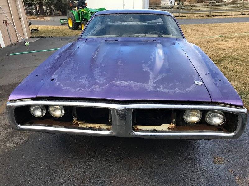

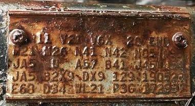

is this a 73 rallye big block car?

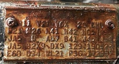

Yes. A57 is the Rallye package, V21 is the performance hood treatment. I saw that one on Facebook. Could be a decent buy.
400 magnum engine
that's the car im in the process of possibly purchasing...floor pans need to be replaced though and not original motor

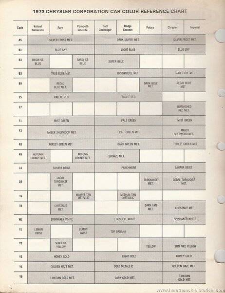

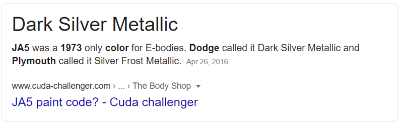

Yes. Interesting paint color, but appears to be silver which according to this source was only for E bodies.
Code Description
E68 400-4 Barrel High Preformance
D34 TorqueFlite Automatic Transmission
WL21
W = Dodge Coronet / Charger
L = Low
21 = 2 Door Coupe
P3G
P = 400 260HP(net) 1-4BBL 8 CYL
3 = 1973
G = St. Louis, MO, USA
172937 Sequence Number '172937'
JA5 Paint Code: Unknown At This Time
B2X9
Trim Grade/Style/Color
B = B Class
2 = Vinyl Bench
X9 = Black
DX9 Upper Door Frame: Unknown At This Time
129 Date Built: 1 / 29 / 1973
190523 Order Number: 190523
JA5 Roof Type OR Color: Unknown At This Time
U Built to Specifications for USA Order
A57 Challenger / Charger - Ralleye
B41 Front Disc Brakes Some Yrs. Power
J45 Hood Tie Down Pins
M21 Roof Drip Rail Moldings
M26 Wheel Lip Molding
N41 Duel Exhaust w/o Tips
N42 Chrome Duel Exhaust Tips
N85 Tachometer
R11 Music Master Radio AM
V21 Performance Hood Treatment
V6X Black Longitude Sports Stripe
28 28 inch radiator
END End of Codes
very interesting...wonder how rare it is...that would be cool car to restore back to original

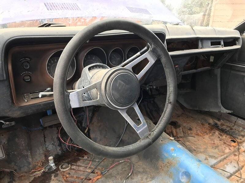

its an odd duck...floor boards are originally blue...fender tag does not state anything about fender mounted turning signals...
being WL21 ( coupe ), sure is not a common car. Most Rallyes I have seen are WH23.
A57 denotes is a Rallye. V21 is the blackout hood treatment, which is not present in all rallyes, because was optional
fender tag and title match, i just asked him to verify the vin
wouldn't the fender tag state fender mounted turning signals?
well... with the fender tag full like that maybe would appear on the buildsheet
actually I have seen dozens of 73 Charger silver, most of them SEs. and the paint chips states Coronet too... Chargers enter into the Coronet line
Based on the tag in your pic, A57 is a Rallye car, V21 is the hood blackout treatment if wanted, 400 magnum, JA5 I do believe was a dark metallic silver but I thought it was for E bodies. I guess the sales person was able to make that happen. But I question the fender mounted turn signals......
the vin matches the title which matches the fender tag
