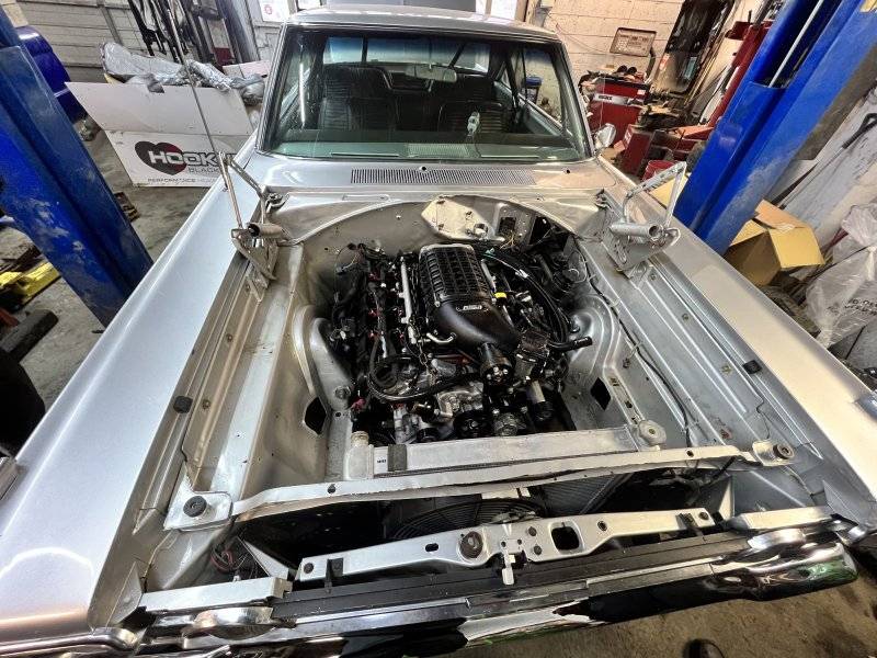

I have a 5.7 AND the Nag1 . It sounds great, particularly when I close the cutouts!!!! The performance is trouble free. My only reservation about your "deal" is how many miles there are on that engine. What even got me to start thinking about such a swap...way back in '07....was that I was driving an
06 Charger with a 5.7 and I had a '69 Dart with a stock 340/727. I realized the 340 would give the Charger a run for its money in the first 1/8th maybe and I wondered how bad *** that 5.7 from the Charger would be in a GTX. The result was/is spectacular! If you do this, do NOT stay with the 727. Soundgermanautomotive.com even has an aftermarket controller for the 8speed now, THAT would really be awesome in my GTX! You would even have slap shift so you could drive manual shift if you want. It is fun once in a while.
Here is a link to my build on this site
https://www.forbbodiesonly.com/moparforum/threads/b-body-stiffening.1121/
Holley has all the parts to do the job in the process of finishing my 1967 Holley terminator max and sound German trans controller.

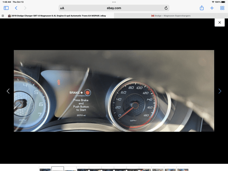

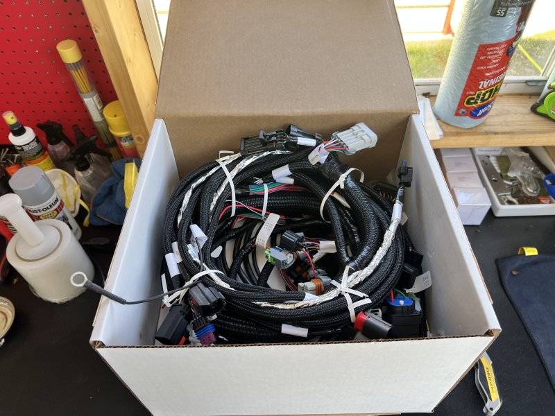

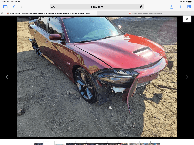

I keep having this debate with myself for my Coronet. Started building a 5.7 single turbo setup but HC comes down in price
There’s one ebay right now for 10k. Then they go up from there. Why not just by a crate Hellaphant? Don’t they come with a harness and controller?
You can buy them all day long for $9-10k, fully dressed engine. Then you need a controller.
5.7 you have to debate how hard to push it before pulling down for ring gap, HC you don't.
Your not buying a fully dressed hell cat engine for 9-10. No way. I’ve been hunting. 17-23k. All day. Normal
6.4 yes 9-10. Your not buying at supercharged hemi for 9.
