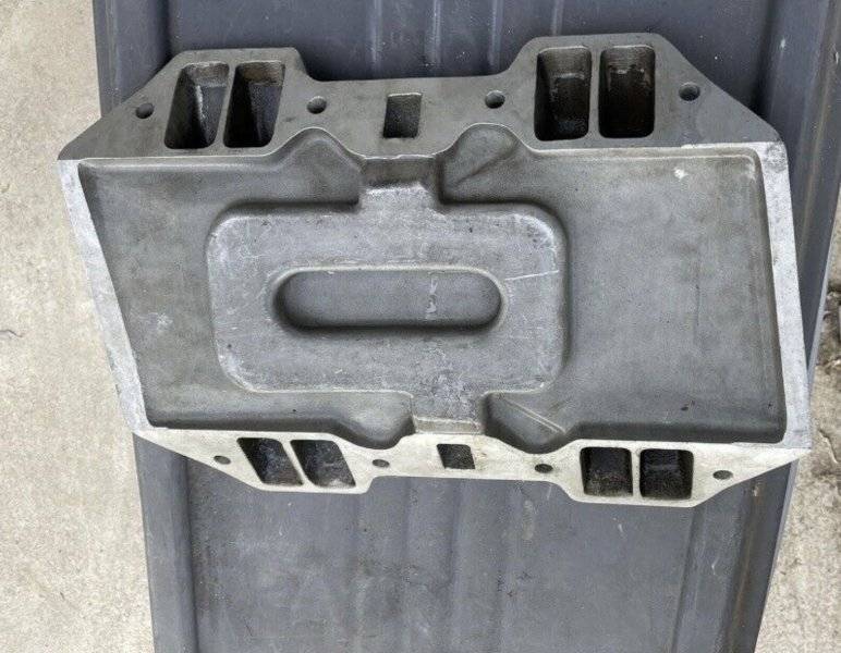

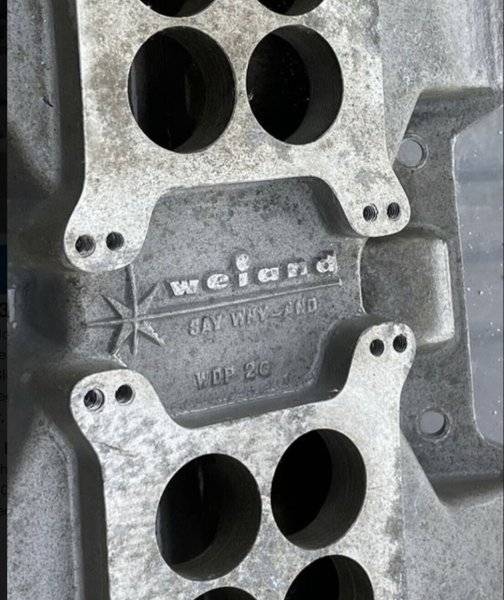

I tried finding a site for Weiand casting numbers with no luck. Can someone educate me if this intake is for Max Wedge heads? Ports look like max wedge size to me. Thanks!
How tall are the ports? Std ports are about 2 3/8” tall
it has heat crossover passages which max wedge heads don’t have.

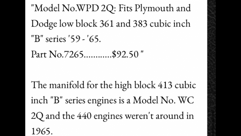

Looks to me like a 361-383 intake, opened up to max wedge size. Certainly not a factory anything, other than the Weiand factory. (DP on a weiand or edelbrock in those days meant low block, for dodge/Plymouth, CH for chrysler, would be found on an RB.)

Thanks fellas just wanted to verify, cuz you never know. I dont know why Holley doesnt list the casting numbers for Weiand?

They would for an extra charge cast their intakes with extra Aluminum
so that you could port it to Max Wedge size. That was much easier than
building up the intake yourself.
The pictured intake does not have that additional built up area on it.
I am 100% certain the seller used the new "A.I. assisted" item description option. Have any of you actually read the whole description? It almost sounds like a bad translation of Chinese assembly and operating instructions into English.
