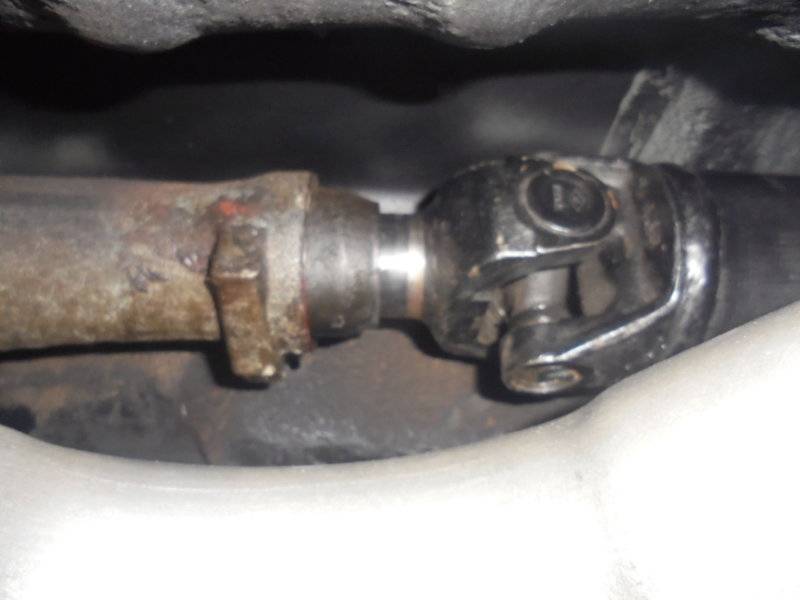

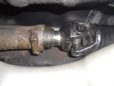

I put this drive shaft in a driver and it looks a little close to the 727 what do you think?

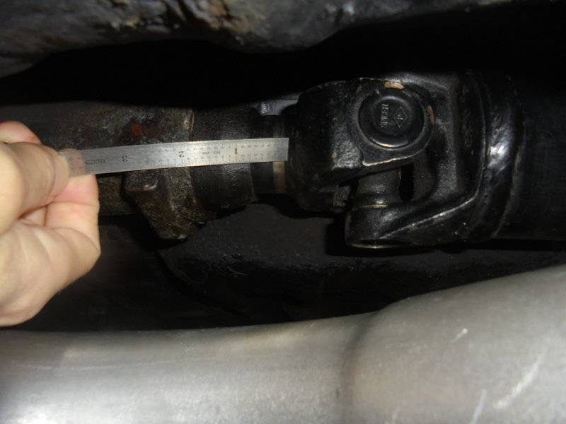

With the full weight resting on the suspension, how far forward will the yoke go into the trans? Hard to tell from the pic. You need 3/4" at the minimum..
If the weight of the car is on the wheels, your good, if not, your screwed!
That rubber boot is probably over an inch long. You can be closer to it than if you were comparing it directly against the seal with no boot.

Is the end of the ruler actually where the yoke butts against the trans? It's so close if I were you I'd take the rear straps off and slide the driveline all the way in and note exactly where it stops. The yoke may bottom out sooner if it stops against the inside of the trans, as dvw Doug alluded to. That big bushing-looking thing on the end of the tailshaft...that is a pre-66, yes?

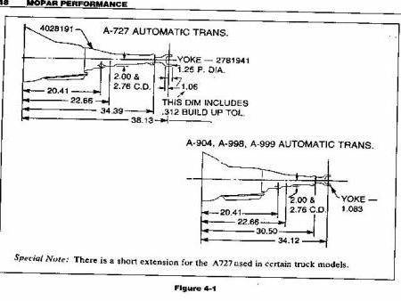

This factory diagram shows the centerline of the U-joint being about 3.75" from the rear of the tail.
