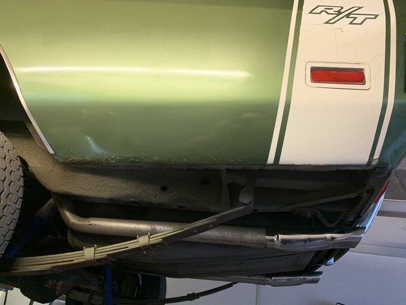

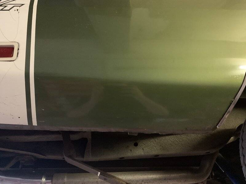

Yesterday somebody told me he would cut those pieces out and replace them with new AMD sheetmetal.
Well im not a body man but it looks not all that bad to me?
So im surprised by that statement.
Do you guys think thats necessary?
Whats the alternative? (If there is any)
Consider the car is all original sheetmetal right now.
Im not disgusted how it looks but i get if you dont do anything it most likely gets worse.

Probably opening a can of worms ... you cut the lower quarters off then find the trunk extensions have rot - may as well do those too! Next thing you know the car is sitting untouched for ten years!!
Besides, its always easy to say "what you'd do" when its not your car !!
Tough to tell what’s there or not but it would seem that just a little piece of the patch panel and a tig butt weld would fix what’s needed and not more.
Thats also my fear. :D
The undercoating is factory or dealer applied. Its on the original invoice.
But i also do not really want to know how it looks under there right now. Hopefully not bad.
At least at this point i do not want to go from "repairing" to "restoring" which could potentially happen really quick if you dig too much.
Spray it with Krown (inside and out) and drive the hell out of it..
Sounds like a good idea, at least for now.
Im not feeling it but then again its not my car. A decent metal guy can fix that but you never know what your going to find. I would not just let any yahoo touch my car,I want to see his work and talk to some people.
You start grinding on there and you know whats going to be uncovered. Wait till winter, You can work below that 1st body contour. Little body steel and a metal break. Thats not that bad.
Someone that can paint can blend up to that contour. You will need to replace the stripe though after welding & paint work
It looks not to bad now, if I had the car I would spray a rust/preventer, killer, don’t know how well they work and enjoy the car especially if all of the rest of the paint is nice.
Are ever planning on selling the car, or is it just for you. And it depends on your expectations and age.
Yes i also dont think it looks too bad and i WILL spray some rust preventer/killer on it.
I would also fix it but as has been pointed out bevor, i might find something i do not really want to see. :D
Well my plan is to fix everything mechanical/electrical that isn't working and then looking at the body/paint.
There are paint flaws all over the place but very little (at least visible) rust.
Im no paint/body guy but i think the paint is fixable for someone who really knows what he is doing.
At least i do not want to repaint the car. Because its not too bad and original.
I'm just a little anxious what's hidden behind the panels and undercoating.
Well maybe nothing, maybe a nightmare. :D
