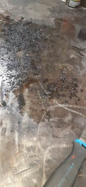

Got the sump off. HOLLYS**T! I'm surprised I had any oil pressure. There were some big chunks in there and a lesson on RTV.
Spent some time at the parts washer and compressed air. Using the tiny camera on the scope, she looks pretty good now. Need to get 5 more gallons of cleaning solvent and flush (ugh, don't use that word) out the motor. Need to go ahead and pull the rocker shafts and rockers.
