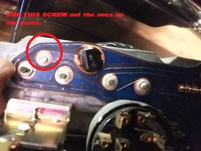

Do not use the speed nuts. Use the screws with the slotted head. The speed nuts are on the gauge itself. The other screws are grounds. If you hook it to the speed nuts you could fry your fuel or temp gauge.
Thank you for the help. Will do that, extra grounds never hurt. Looking through electrical prints, how does the dash circuit board get to ground?

Good evening FBBO'rs. It would seem pnora and Don Frelier and RJRenton got this one. After correcting polarities on the led's, there was still one bulb that would flash when key was turned on. Noticed it would flash after gas gauge would rise and settle at tank level. The flashing bulb socket shared the same ground tracer on the dash circuit board with the gauge voltage regulator. Flashing issue went away after adding a pigtail ground directly to the shared tracer ground of the voltage reg and the offending flashing bulb. I can only figure the volt reg was affecting the shared ground after bringing fuel gauge to operating position.
