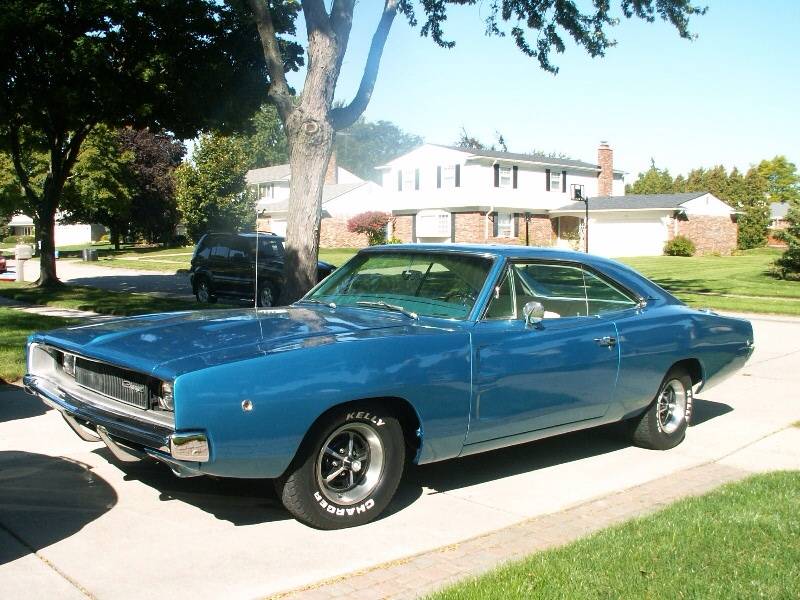

I've expanded my mopar stable by adding a 1968 Dodge Charger to my 1974 Challenger (you can find information on the Challenger at the following location: http://www.cuda-challenger.com/cc/index.php?topic=77949.0 ).
I purchased it in the Detroit area of MI and then drove it 200 miles home to Ohio. It was a bit of a white knuckle experience as it is an early 68 with no shoulder belts, no head rests, manual drums on all 4 corners, and an Inland shifter. It survived the drive without any real issues.

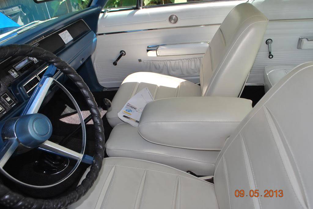

It was an AC car (rare for a 383 4 speed I'm told). The AC was removed, but all the big pieces were in the trunk (compressor, hoses, etc). I'd like to rebuild/replace that at some point, but that's a down the road type of thing.
Mechanically it seems pretty solid. The oil looks good (but I'll change it just to be sure) and my mechanical gauge put it between 35-40 psi at idle. The brakes are good, so it stops, but it's a manual drum car so it still doesn't stop all that well. A conversion to at least front discs, possibly front boosted discs is in the future.

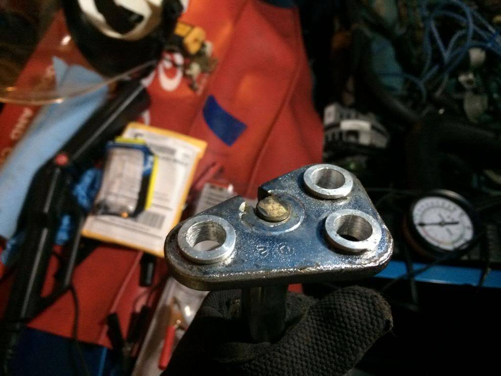

It has an Inland shifter in it. The amount of slop was incredible, but I had read that was a common complaint about the Inland "guess-a-gear". I took it apart this morning to get some measurements for the grommets (which probably failed decades ago) and discovered the top bolt of the 3 was missing. I put a spare bolt I had laying around the garage and that really tightened things up.

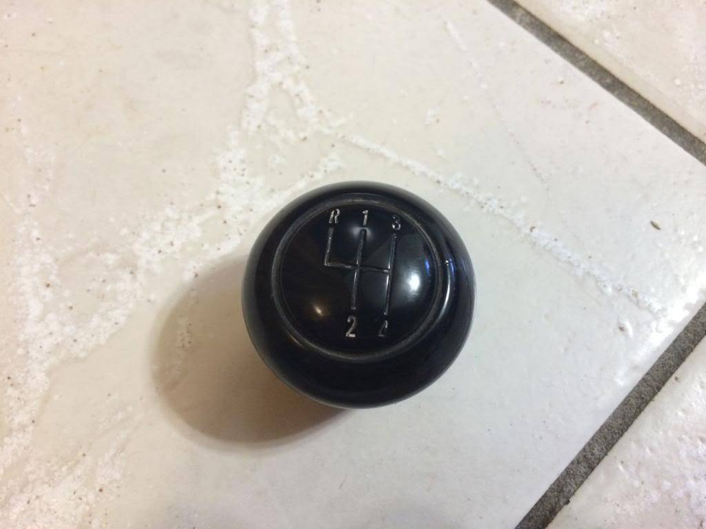

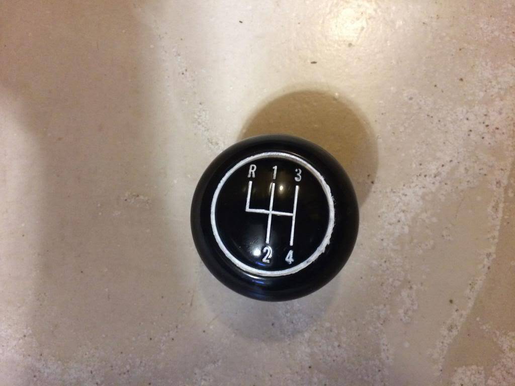

Been working on getting the car legal (fun at the BMV) and collecting parts before starting any of the larger projects. But I did find time to pull off the shifter knob and give it a bit of a touch up.
Before:
After:
Needs a little clean up and maybe another coat, but for now I'm happy with how it looks.

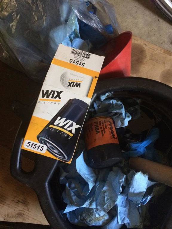

Spent the week visiting the BMV and getting the car transferred and plated. Once that was done I changed the oil. The oil that came out of it looked pretty good, but that Fram filter had to go. So out with the old in with the new:
A Wix and 5q of Brad Penn.

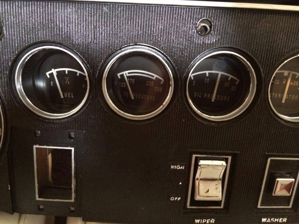

Since I got the VIN inspection done, I no longer need to drive the car so I took a deep breath and pulled out the dash to try and trouble shoot the gauge issues. I pulled it, inspected it, then swapped the voltage limiter with an RT Engineering one and put it back in hoping it would fix everything.

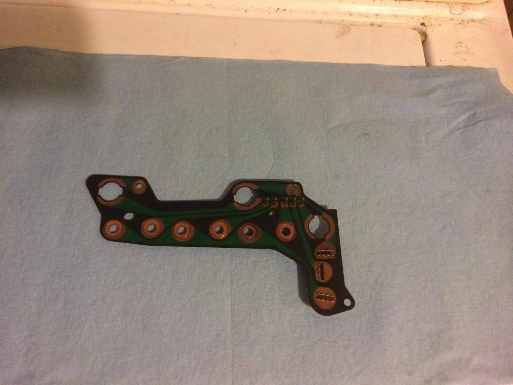

It didn't :( I know the speedo cable is bad, and a new one should arrive next week. I ordered a tach rebuild kit (also for RT Engineering). As for the oil/temp/fuel gauges, I disconnected them and did a quick test with the 9V battery. All of them sweep so that's good. So I pulled the printed circuit board and cleaned all the contacts.
After cleaning, I tested every contact with the ohm meter and got good readings from them all. So I reassembled the cluster and did a quick test with the 9v using the pins. All of the gauges sweep. I even tested the lights and they work as well.

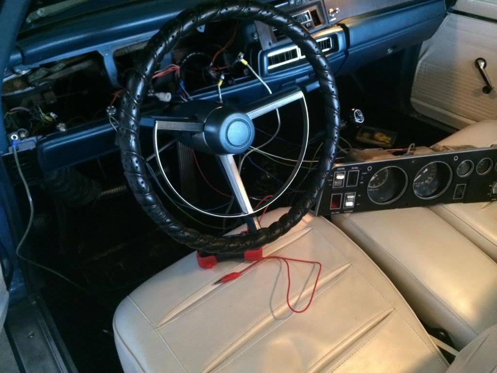

Well I wired up an extended harness (thick speaker wire for the alternator and grounds, 5 regular sized wires for the rest of the cluster) and hooked up the dash on the passenger seat while I started the car.
Success!
The fuel gauge seems low and I didn't run the car to get it to temp but the needle was climbing. Oil pressure matches what I got on my mechanical gauge I had hooked up last week.
Now I just need to rebuild the tach and install some better switches :)

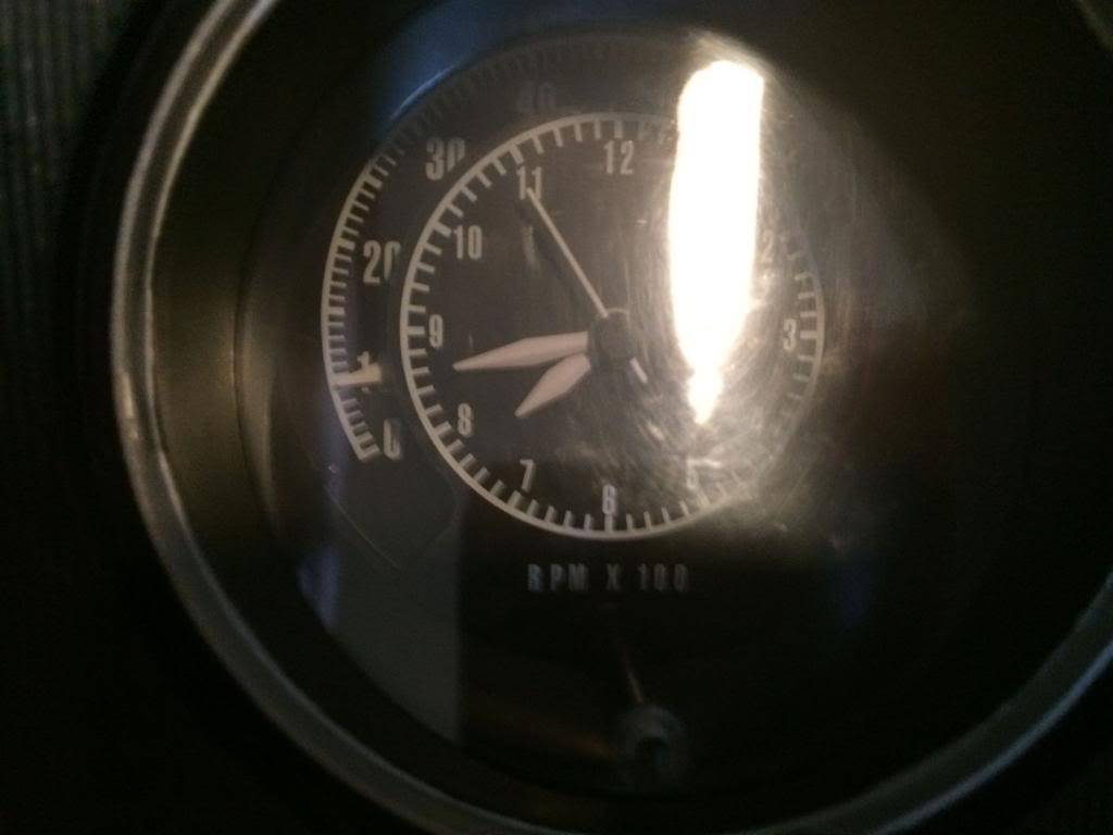

Spent the week messing with the tach. I swapped in a RT Engineering board but I just couldn't make it work. So I ended up just biting the bullet and ordering a new one. I also ordered a replacement voltage regulator, just in case that was part of the problem. I hooked everything up and ...
Functional tach (not the best picture but it's within 50 RPM of my timing light's read out).
Since I've had the dash out of the car for a while, I set the dash up to run remotely.
The tach and all the small gauges work with it sitting in the car like this. I also decided since it was apart I'd swap in LEDs. They should show up next week. All I am waiting on now is some replacement switches and I should be able to put everything back together.

I also received some bushings for my Inland shifter. One of my friends machined a set up for me. I did a little fine tuning and pressed them in with a vice. Now the dreaded shifter slop is gone!
