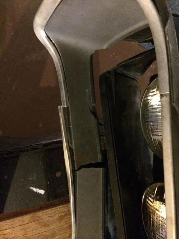

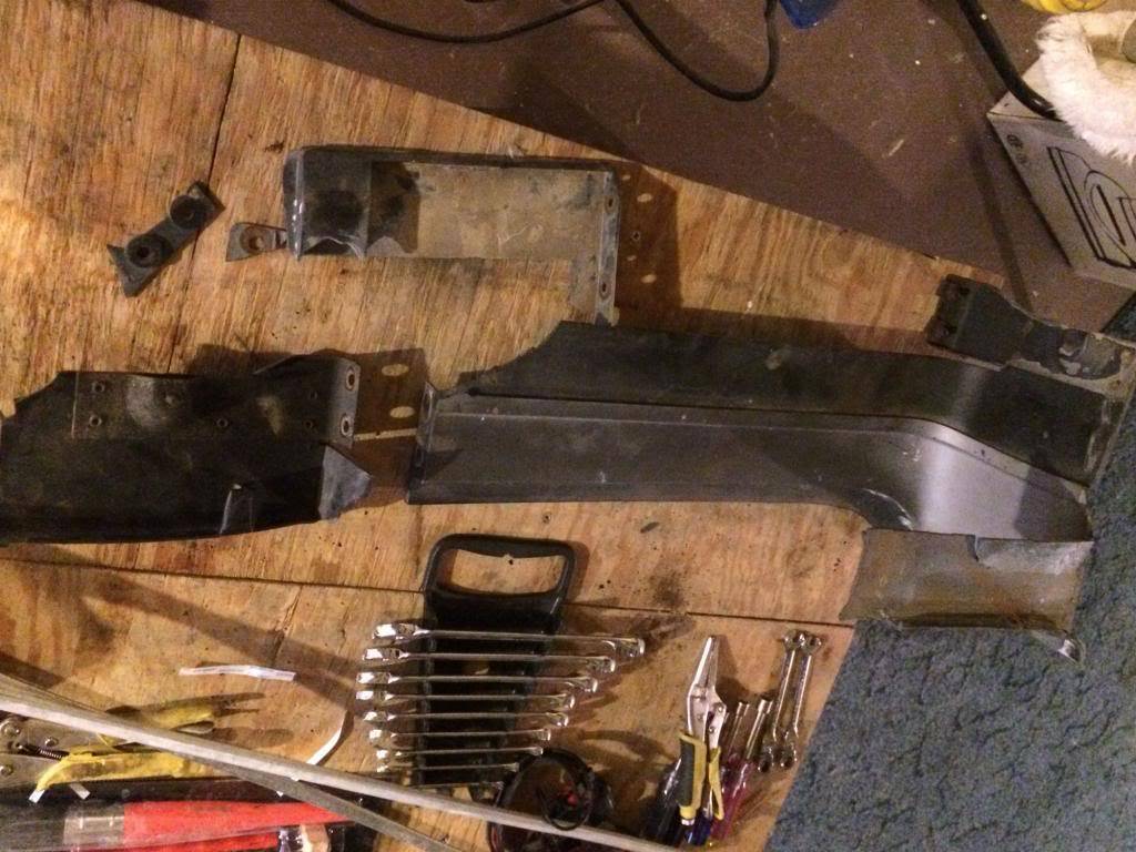

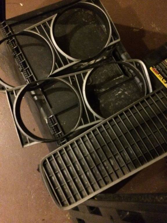

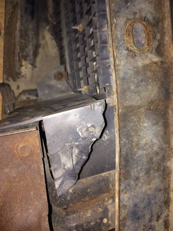

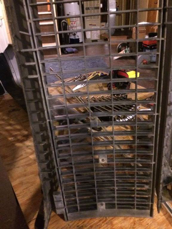

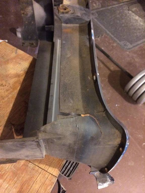

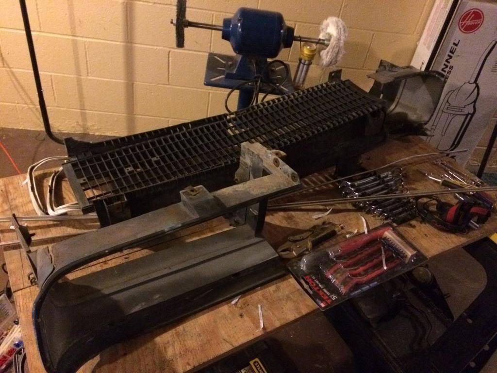

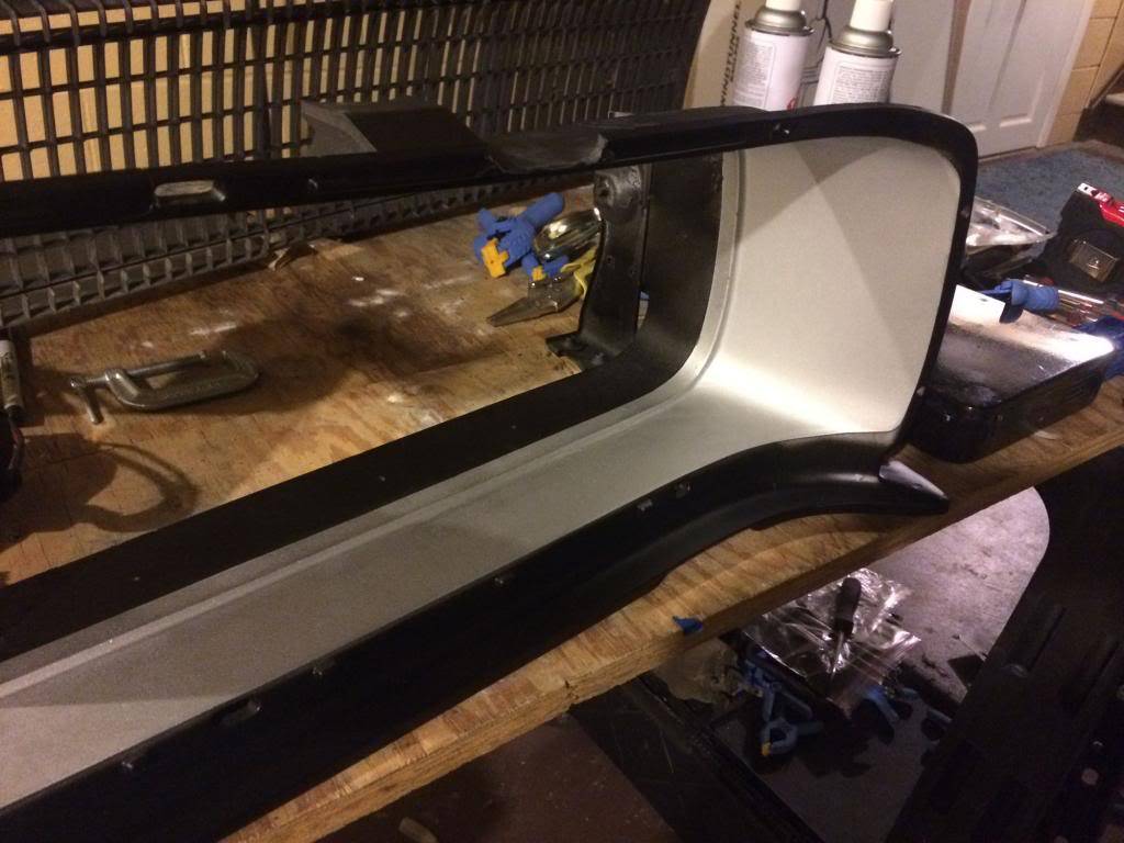

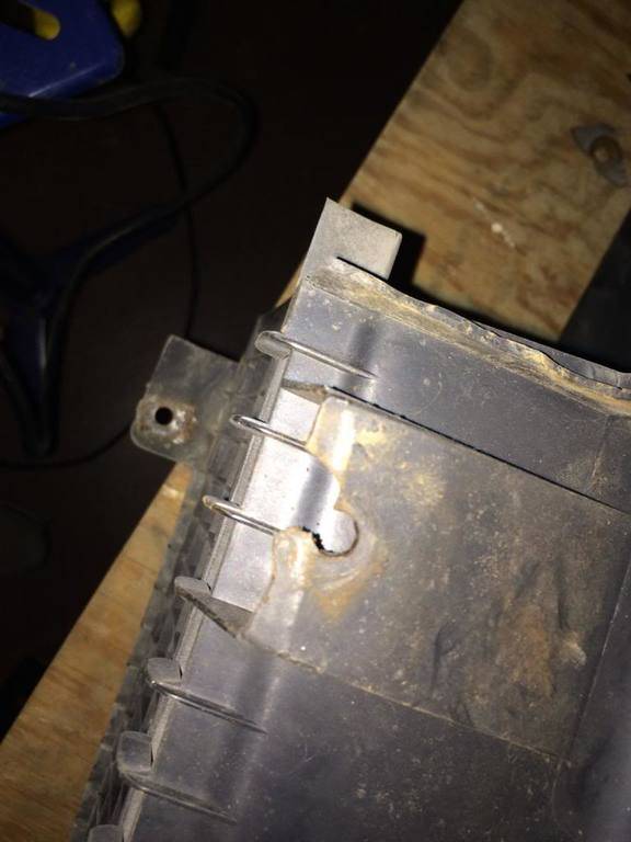

great work on that grill, man you have some serious patients, do some nice repairs too... keep up the great workI finished repairs on the driver's side surround. This is the part I was the most concerned about. This is what it looked like once I got it out of the car:

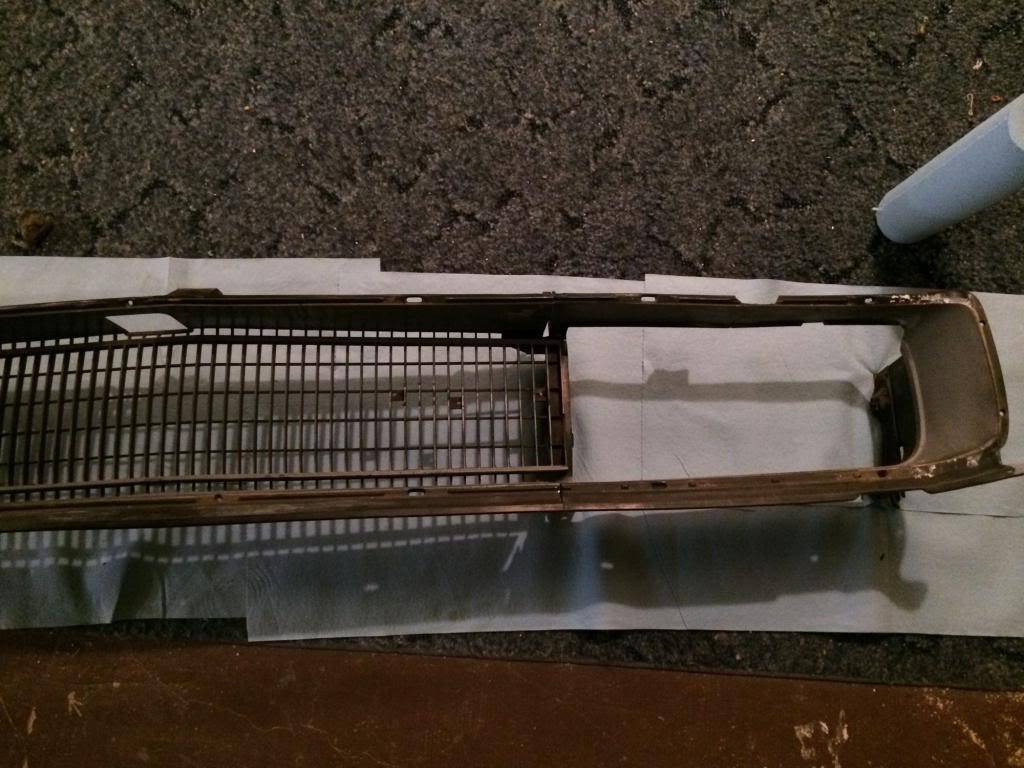

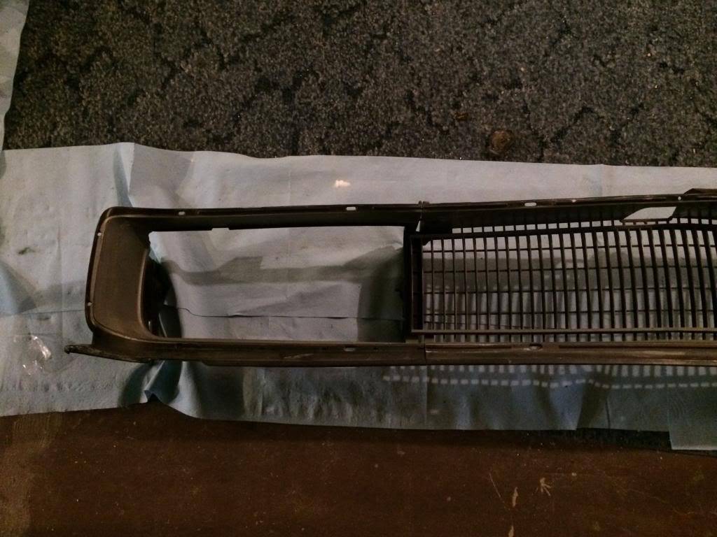

And this is what it looks like now:

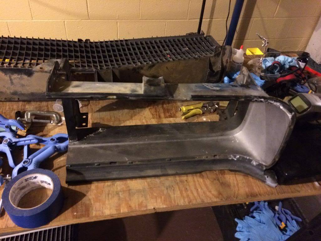

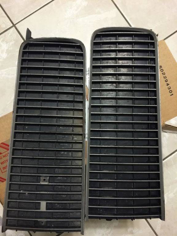

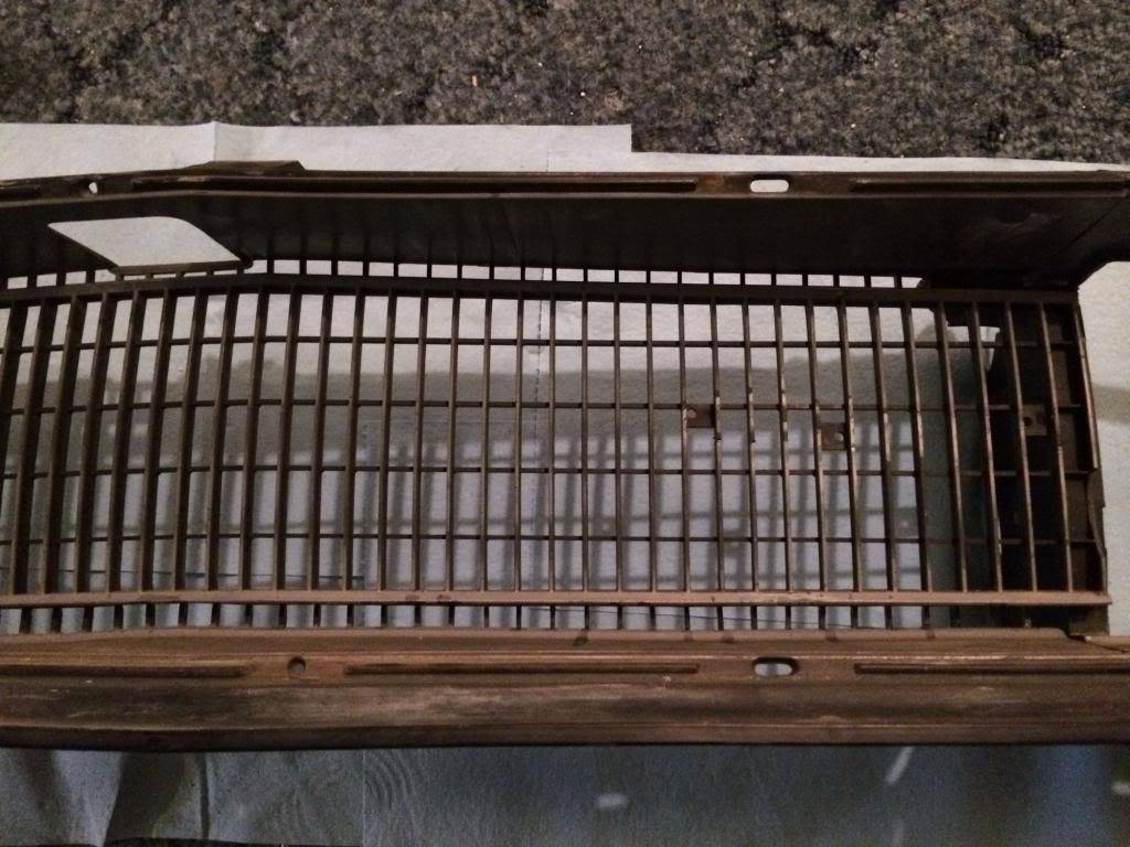

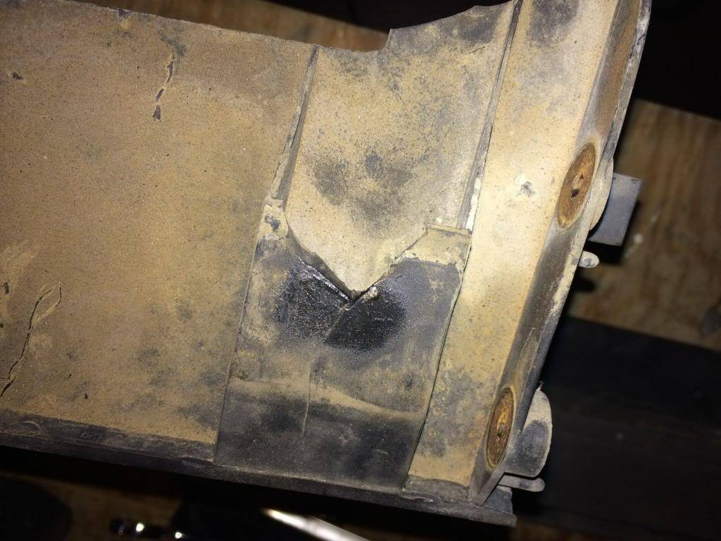

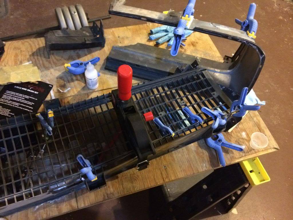

I also did a lot of repairs on the center section. The small fins that connect the grid work to the edges were the majority of the damage, the driver's side was by far the worst. In the end I repaired/replaced 19 of the fins on the top and 28 of them on the bottom. Big thanks to member 1970 RoadRunner for supplying me with several fins along that I needed for the repair.

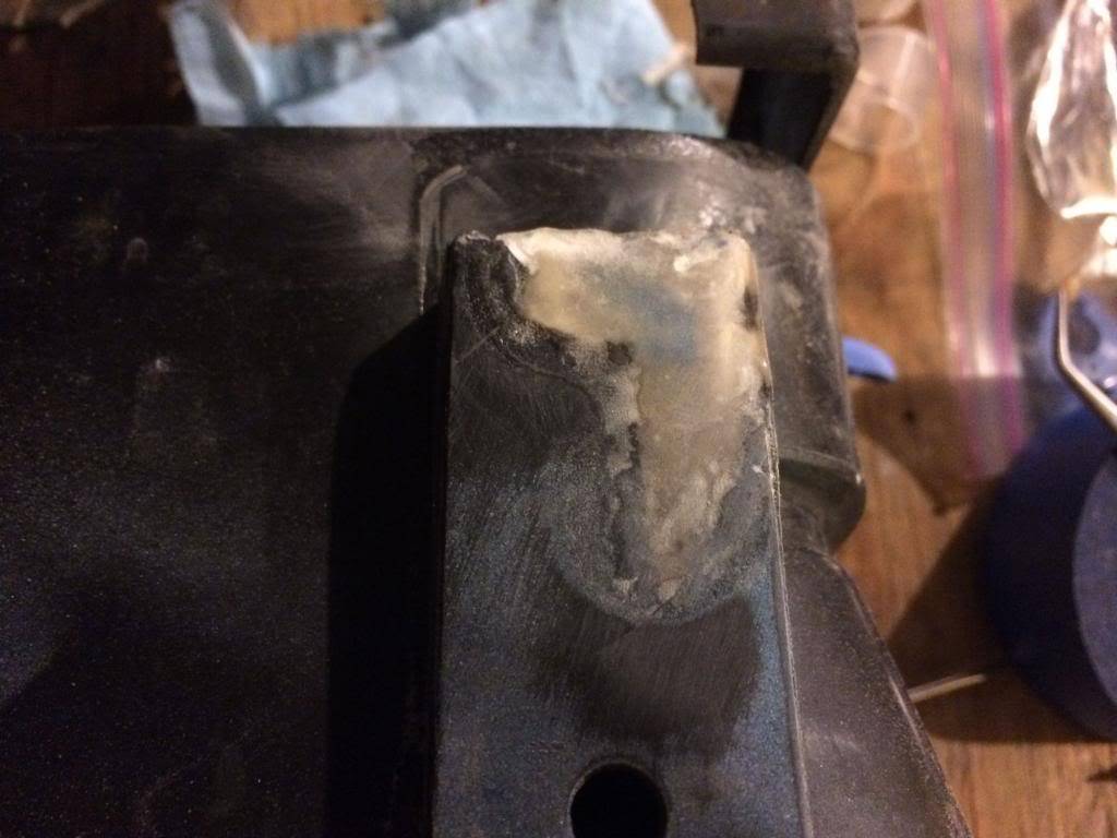

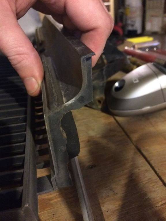

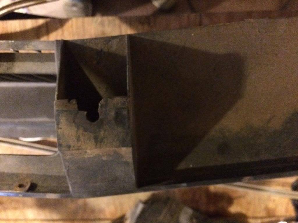

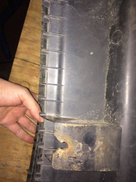

I also did some work fabricating a repair for one of the tabs. Not sure if this is the way I am going to go. I might just grind up some ABS and liquify it for the repair. I'll try one of those next week.
Here it is test assembled on the floor (to make sure I didn't screw anything up):

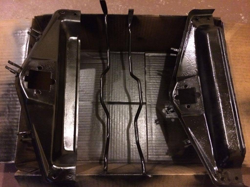

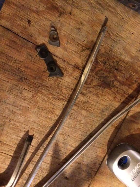

And finally I removed the surface rust off the actuator arms/mounting brackets and gave them a fresh coat of paint.
