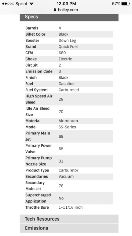

Leave jetting alone for now. You'll have to work on your idle and transition circuit. Will it idle if you turn the screws in a bit? What idle air bleeds does it have? How much transfer slot is showing on primary's and secondaries?
My QFT/pro form carb needed a lot of work down low including reducing the size of the ifr, putting transfer slot restrictions in, and air bleed changes. It now idles at 13.5, goes down the road in the high 13's/low 14's and is low 12's at wot (that's what it wants). Granted I built my carb from a 850 into a 1050 with a main body, but them things being really fat down low sounds like a very common problem.
Thanks for the info, I'm not sure why I didn't remember there are 2 circuits.
I'll work with the idle air bleeds first before I do any thing else.
