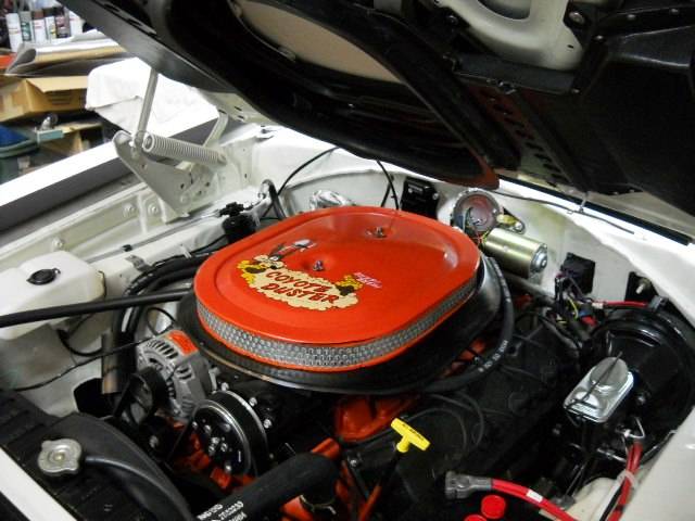

Nice job getting the AC compressor under the aircleaner base!
Working on the belt routing diagram that goes on the shroud. Need to trim the base plate to clear the a/c and alternator. Have to figure out which way to paint the dipstick "T". It is the final eyesore under the hood.
Just finished and installed the last of the correct Air Grabber screws.
Nice job getting the AC compressor under the air cleaner base!
The factory didn't fit so i put in a Sandin. I cut 2" out of the air cleaner base and moved the new center toward the rear. Then I had to disassemble the AG box and remove 1-3/4 from the bottoms to allow the cleaner to sit correctly. Two weeks of fiberglass redesign. It has a correct p/n radiator from Glen-Ray.
