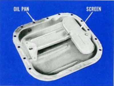

No it's a 413. i have not seen it, I'm only seeking info for my brother who is helping out a Handicapped friend. 32 Ford sedan 413 with suposed 727 that's "PUSHBUTTON" drive. Says there is no filter in the tranny and can't see where one would go.
Just talked witg my brother, the pan is square, so we KNOW it's not a 727. The dipstick tube screws into the side of the pan ???? Any ideas? Don't know if it's a 2 or 3 speed. And though question was not considered before, my brother believes it's an aluminum case. #'s on pan rail read 220475325 1885665. He grabbed this info while he was there sometime yesterday. So when we were talking, he was no longer at the car
If the pan is square, or rectangular, then it is likely the earlier A-488 torqueflite. Check the case to verify that it is cast iron and not aluminum. Also, this transmission had no "park" feature, relying on the parking brake. Some had a driveshaft mounted brake for this purpose. Some sources list this as a A-466 transmission as well. Does your pan look like this?
