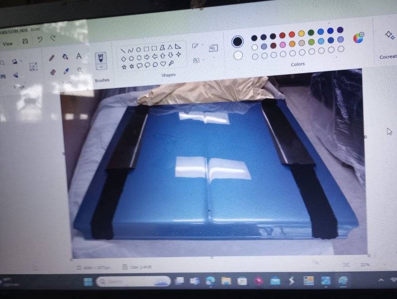

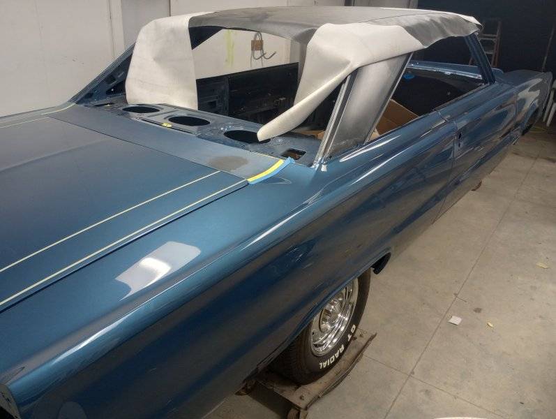

Is it my eyes or are you making the hood scoops functional?
Nice work Mark. I opened the factory scoops on my Cuda. I lean towards body colour with the black stripes, most people will probably never notice the changes. Thanks for the cigar, cough cough.
I think I prefer blue on the sides and the black stripe over the top.
Once again you amaze me Mark with your work.
The scoops look fantastic! What I really like about them is that they are disguised in plain sight - they are different, but it takes an extra look and some experience to see that they are different. This is the whole idea with my 70 Road Runner. (And I may just have been a little bit of influence since Barry has spent many hours behind the wheel of my 70 )been too long since the last update..... working on 4 major projects at the same time .... hence the delay

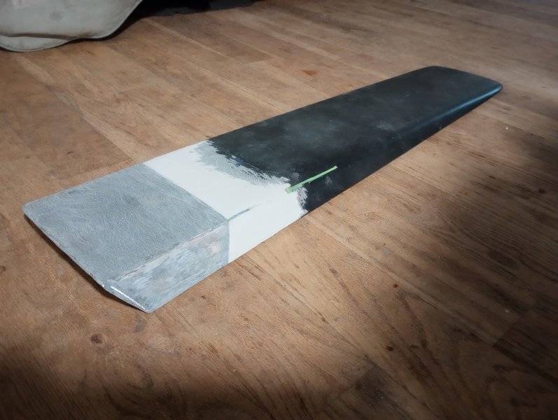

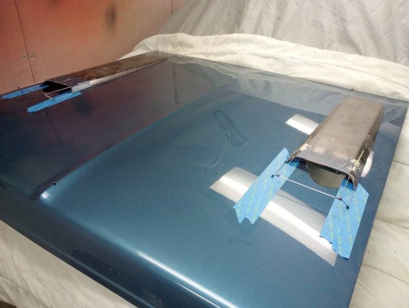

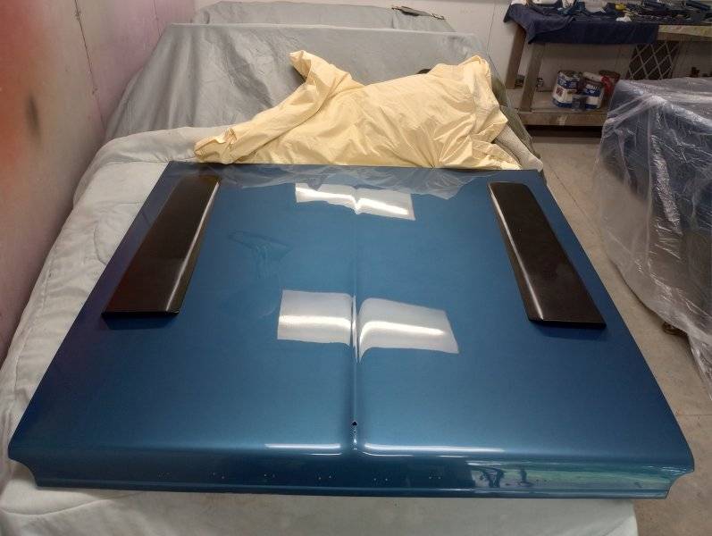

and since the cat was let out of the bag (sort of on purpose)...... and Dave @qkcuda picked up on it (give that man a cigar); let's talk hood scoops, shall we?
the main problem with 67 GTX scoops, is they are tiny........ and the "back cut" opening is less than aggressive in appearance.
if you remove the bezel mounting area, they offer a "mail slot" to pull any air through, which in no way would work for any type of "air grabber" type set up......
but if the trapezoid shape scoop is extended, the size of the opening quickly increases in both height and width; and a "front cut" looks more the aggressive part, and also hides the hole.......now it can grab some air
so utilizing things I have lying around the shop; I cut groves into the four corners of the opening and built a cage; doing the same exact things to each scoop..... the area where the original bezel mounts is removed, just not in the early pics

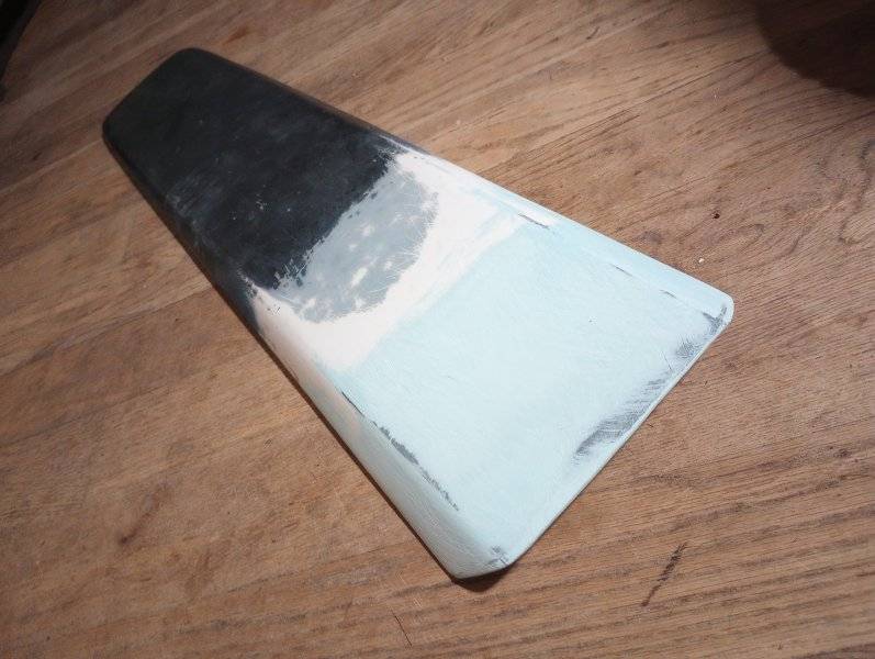

I'll fast forward through step 2 (ancient Chinese secret), and get to some fiberglass......

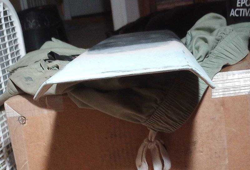

I managed to keep everything the same thickness as the rest of the scoop;
View attachment 1664925View attachment 1664924

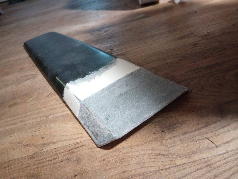

and the evolution continues with a little filler work......
also...... the hood peaks in the center and runs slightly down hill to the fenders; the outer side of the scoop in angled different than the inner side, so as to lift the outer and make the scoops sit level
View attachment 1664926View attachment 1664927

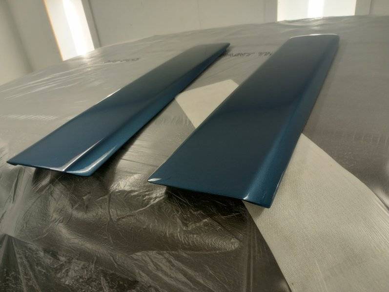

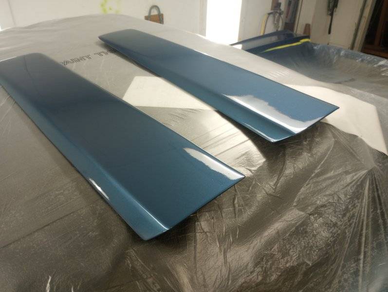

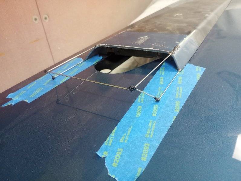

not sure yet of how we will paint them, it is currently in high level discussion; we have a few options.......
but most importantly, after rounding off the sharp corners; we have a nice set of bookends to work with......
I honestly had no plan; when I came upon a small pile of stainless rods; a lightbulb came on and I just went with it
Agree. I definitely think they need some blue body color on them - otherwise they will look like some JC Whitney mail order add on! This car is too cool for that...I think I prefer blue on the sides and the black stripe over the top.
