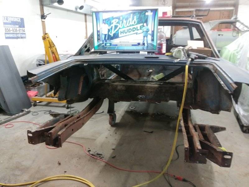

congrats.....you're there.........lotta work, ain't it? just gotta stay persistent

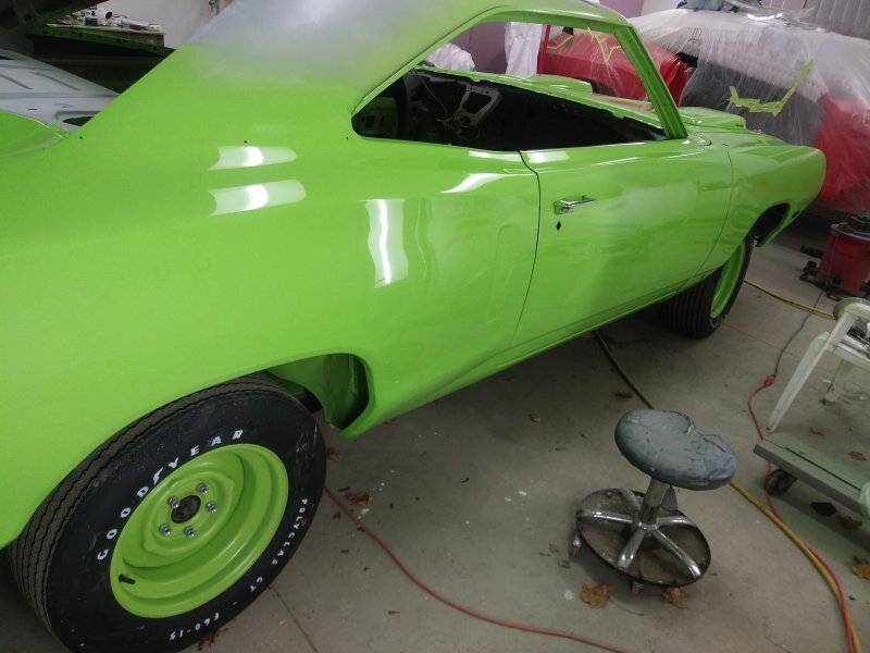

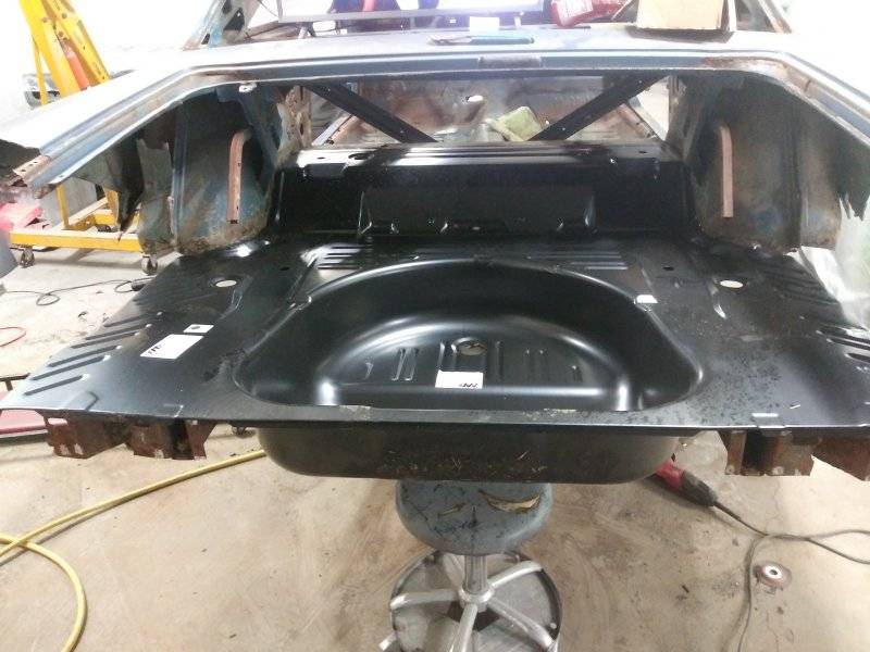

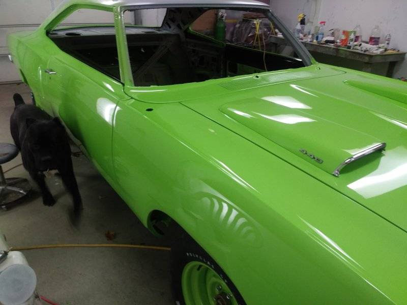

I busted into the 67......love your photo with the stool lol
It is a *lot* of work, lot of moving parts. You make it look easy!
Got to have the stool LOL, but the TV is awesome! Wish I'd thought of that...

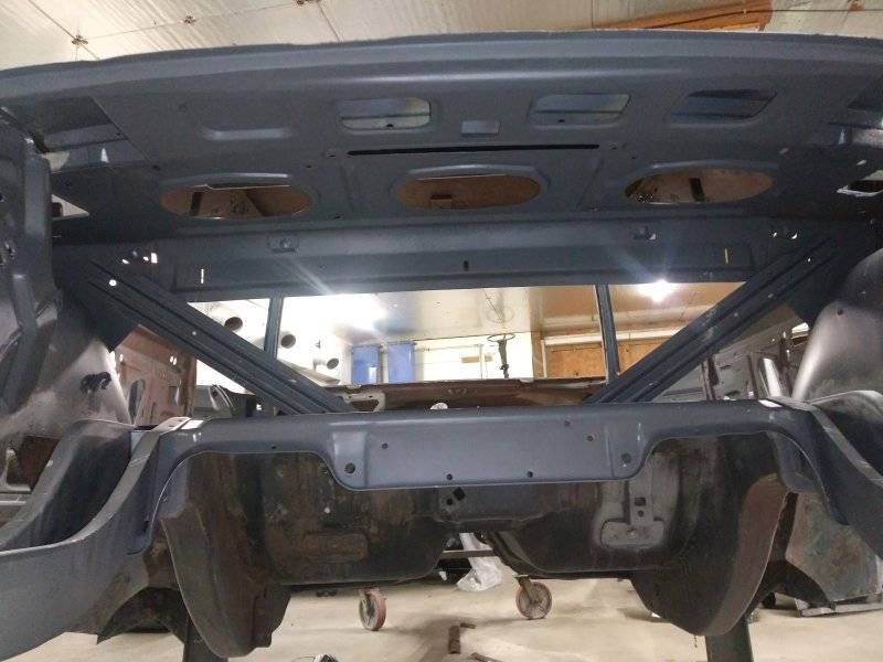

I inherited a two piece pan with the car when I bought it, man do I wish I had just spent the money on the AMD one piece.
Looks like you're off to a great start! Rails look solid. Looking forward to seeing the wheelhouse / quarter work.
