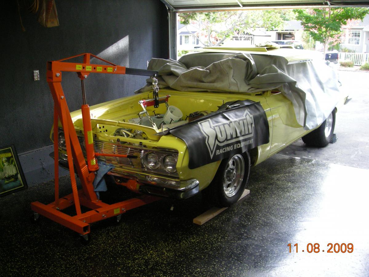

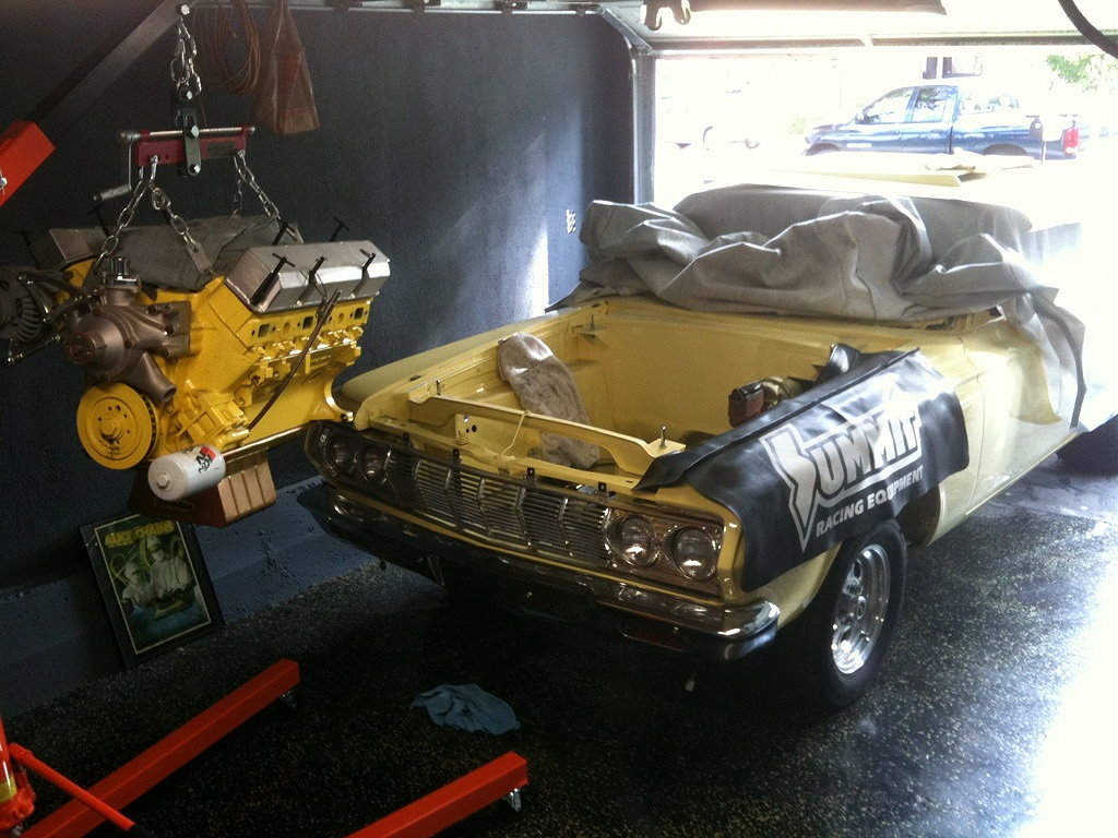

I recently pulled the motor out of the 64 and as it sat there I thought what a great pic this would be. The car sits safely in a completely remodeled garage. I even have my 40" High Def TV on the wall and 7 speakers supplying the sound. The car will head back to the shop at the end of January to have more roll cage installed ( Not enough for NHRA Super Street Class ) and some more paint work. I hope to begin putting it together when I get it back. Like most of us these days extra bucks to finish a project can be tough to find and I have been forced to wait till 2010 to get my car on the road. Happy Holidays to all and I hope to have some build pics to post in the next few months......

Another pic
The yellow closely matches the 67 Dodge yellow. A bit of a custom mix and looks kinda neon in the shade !

I would recommend changing the boom extension arm on that one ton cherry picker especially since you are using that 1/4 ton postion for installing/removing the engine.
My friend had that same hoist (identical down to the stickers) from Harbor Freight and the boom arm folded over causing damage to his new TTI headers, oil pan, K-Frame, firewall, battery and tray. It also ended up snaping 4 studs off in the heads.
I got him a 4 foot hunk of SCH80 square tubing instead of that thin 3/32" it came with. Either way, you probably would be better off going with a 2 ton with a longer boom. Also, you wouldn't have to have the hoist butted up against your grill and bumper.
Just would hate to see that pretty car of yours getting beat up or someone getting hurt. :gah:
