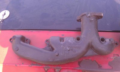

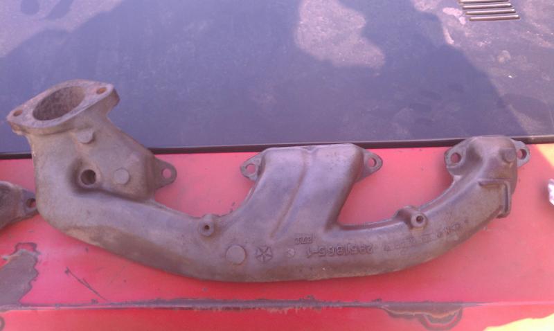

so I was looking at the pics and realized I could see the serial numbers I ran them and they seem to be coming back as to different years one seems to be a 70-71 B-C body left and the other comes back as a 68-69 440 magnum right. now im worried I bought a non matching set I just wrote the guy to make sure that is not the case. hp manifold left side.jpghp manifold right side.jpg
I think they are gonna work fine I just have to figure out what im gonna do for downpipes

should be fine, same on one side for ban d c body, just differnent number thats all
The left one is a 70/1 B/E. Can't read the number on the right one but will work. Is a BB HP. If it ends in 900 its a 68/9B.
The main difference between the years is the clocking of the flange.
HP C-bodies use the same right manifold but a different left one. Has ribs and the flange is kicked towards the side more.
The right HP manifold is the harder one to find as the left HP was also use on LP motors with 3-spd tranny.
