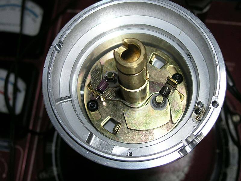

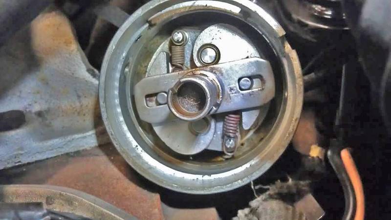

If that is a Mopar Distributor, it may be adjustable and not need the plate. Here is an image of the stock distributor below with the non-adjustable slots and then the second image is the adjustable unit. Those black torq screws can be loosened and the timing plates can be brought closer to limit the curve of the distributor weights.
