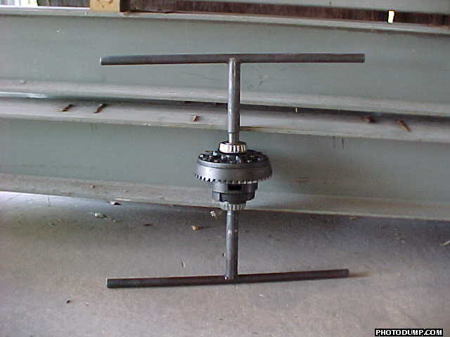

Do these 'pros' know Mopars? I've seen a lot of rears that were worked on by 'pros' that were not right. I also like to take them apart to check for any problems that might be hiding inside but I also made a set of checking tools to see if they still have any grab before buying when I used to go to swap meets a lot....

I guess they know Mopars. They are highly recommended by most out here in Utah. That's a pretty nifty tool you got there. Is that the only way to check to see if the sure grip is good. I was thinking to just rebuild it anyhow so I know it's good.
