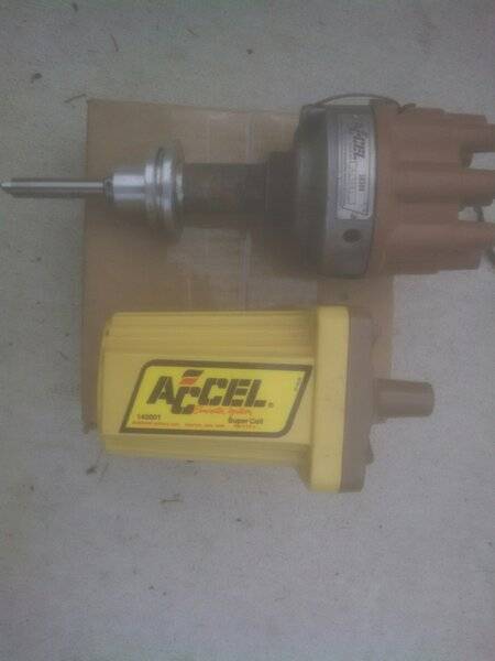

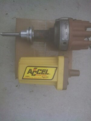

Looks like Summit, Speedway Motors and some others sell that brand.....not sure if they are for Mopars or not.I know this isn't an electronic ignition thread, but does anyone know anything about the Top Street Performance brand distributors?
