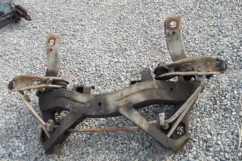

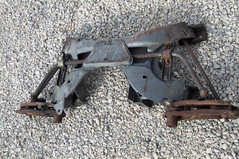

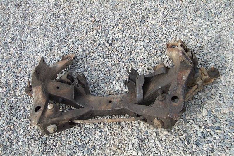

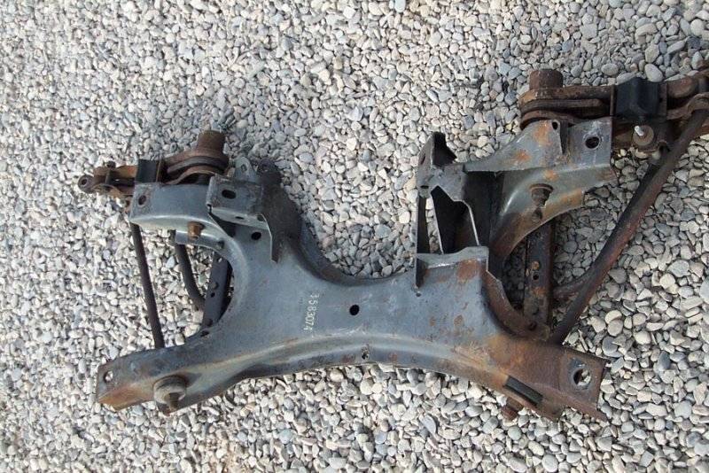

70-72 versa the 73-up frames
thank you, I was always under the impression the 72 to 73 changes were purely cosmetic. I had no idea about the differences in frame heights. I would assume all front inner structure component pieces are also not compatible due to this?
Correct. Nothing of the front suspension, front clip frame and steering system is interchangeable. Not even rear crossmember for T bars or T bars
