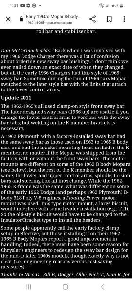

If I remember correctly the '66 and newer K frames moved the engine back. However, stated earlier in this post they move the engine forward when used in a '62. Can someone provide a definitive answer? I have a '69 K frame I was planning on using for a big block swap and now am wondering if I am going the wrong direction.

It'll phisically fit 62-70. But the idler arm mount uses the single stud used up to 67. The motor mount brackets fit 63-65. If used in a 66 or newer the engine will set forward. 62 uses unique mounts. It would work in a 62 if 63-65 mounts were used.

The 66 K's set the engine back in the 65 and older but don't know just how much older. dvw above knows and like Bold and Old proved in post #2, the 65 and older K's will put the engine forward in the 66 and up cars.
when we make Hemi K members from non Hemi K members we use the same fixture for 64-70 When I did my 1965 I had to re drill the tranny mount. It does move it back. The TTI headers fit fine

He did not have a 65 K frame he had the correct 67 K frame he put a fan spacer behind the water pump pulley that was his problem. If you use a later k frame in a 65 and down car the cross member has to be modified it’s about 1 5/8 “ difference.
