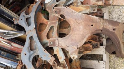

WOW 360 bucks for a plain used V-8 K-frame? I have nice ones for 125.00. If you are going to the trouble of using a later frame then you might as well go with a 68 and up with the improved Idler Arm mount.

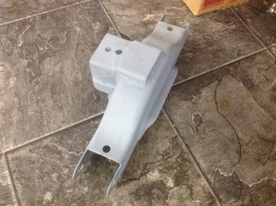

Trans Mount

If this will help, here's a picture of my modified transmission mount. It coincides with the 69 B body K frame that's in my 64 Belvedere. image.jpgimage.jpg
