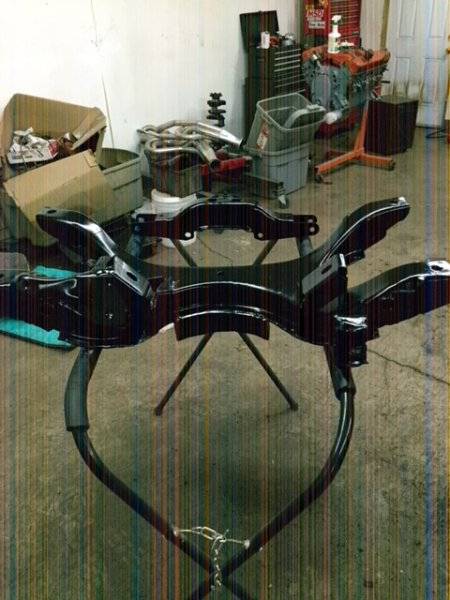

K frame skid plates
That is what they were designed for. That said there are lots of aftermarket oil pans that they will not protect. They do well with all stock Chrysler oil pans.

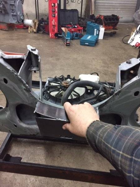

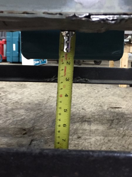

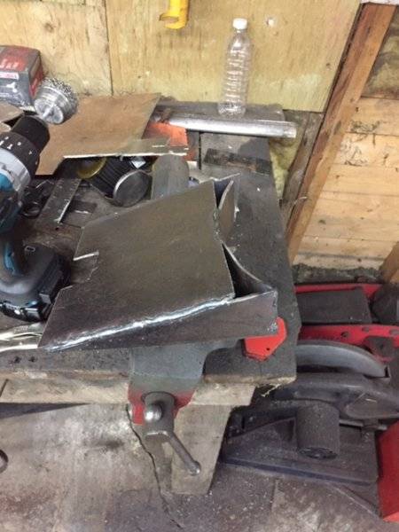

I had to make my own to cover a 2in drop on my Milodon Pan. Not exactly stock appearing but does the trick.
