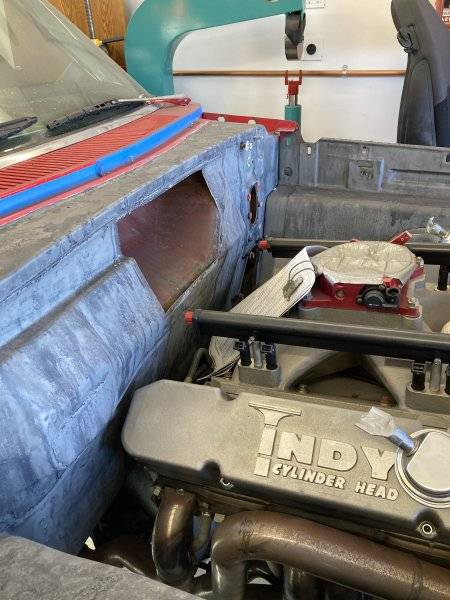

I'm using a 70 unit in mine. Moves it back 1.5". Like Doug mentioned, it uses a through bolt on the idler. Here is a picture of passenger side head to firewall. And yes, it makes the trans tunnel tight.

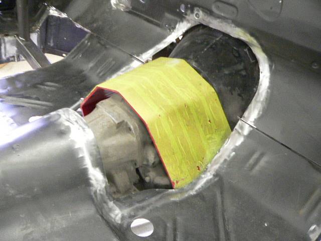

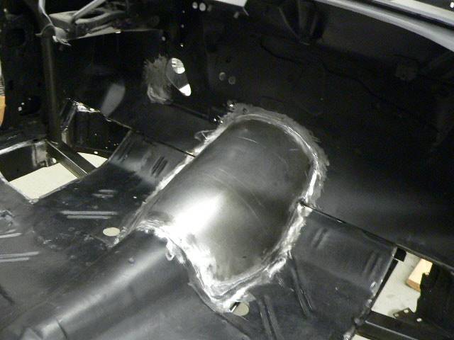

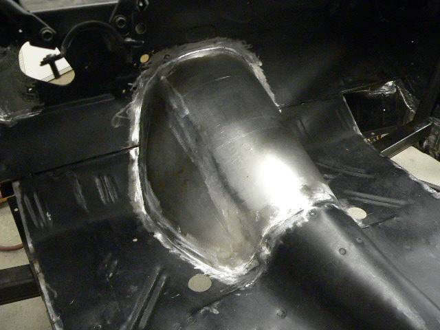

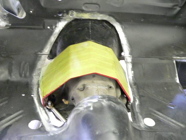

Personally I wouldn't build a car needing a sheild unless the tunnel was enlarged. Doing it during the build process is realitively easy. You'll be way happier when you have to service it. Cut the hole. Bend the metal over something large and round. Shove it up in the hole from underneath. To large a piece is fine. Push it up tight and tack weld starting at the top. Once it's a tacked, solid weld the top side. Now trim the excess from underneath. Weld the bottom seam as well. Then the weld is thick enough to metal finish.
Doug
Nice job on the tunnel. My friends 63 is a classic race car he runs in nostalgia. He doesn't want to cut the tunnel. His preference.
When I built this car it was inteneded to be a nostalgia racecar from the begining. It was intended to look as much like an uncut car as possible. But being a racecar it would need service. The trans can be out in 30 minutes. The engine in just over an hour. Even with engine in the factory location a trans sheild is a nightmare on a 62-65. Even a trans blanket gets squished into the floor. Mine looks stock unless you relly stare at it from underneath. The factory gas pedal still bolts in the original location.
