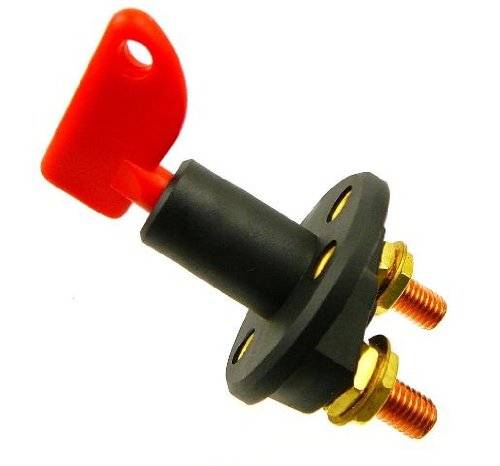

Looking to add a kill switch to my 65 Coronet, but not sure what kill switch to use? What have you guys used and what do you recommend?

Are you looking for something that is NHRA approved ? Or just a kill the power switch because ?

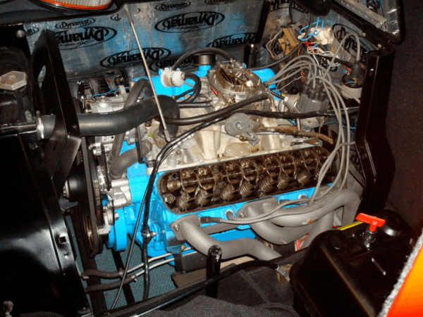

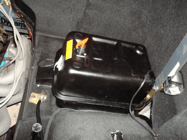

I use a kill switch like one shown in #2 by kiwi. Shuts off negative off battery. Downside is if you run aftermarket stereo with presets, you'll have to reset those every time or any other type of electronic that needs continuous power.
if you want a kill switch to actually cut the power for safety, will need a 4 pole one, to kill not just the main batt power but also the ign1 circuit. If not, the alt will keep feeding back the ign1 circuit.
