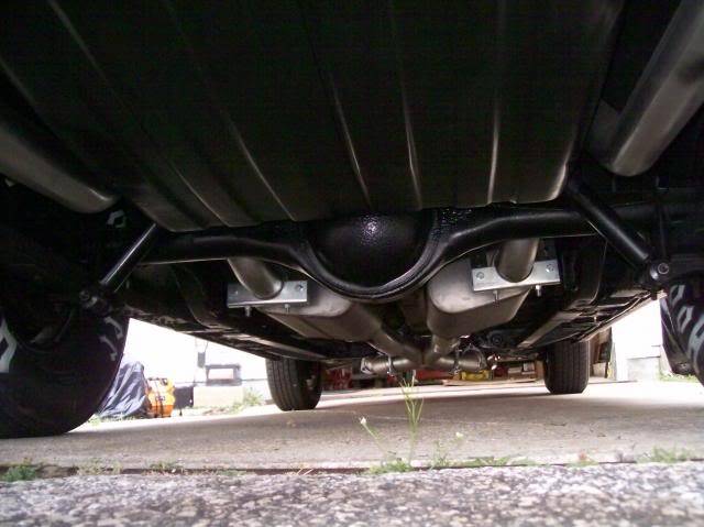

As mentioned many times by many members the drone produced with the Flowmaster mufflers can be mind numbing. After an extensive search on the Internet and reading posts here I had installed a version of whats called a Hemholtz Resonator. It's nothing more that a length of pipe installed on each exhaust pipe before the mufflers and capped at the end. It has reduced the drone by at least 95%!....I can now carry on a conversation while cruising at 40-50 MPH! It did have a slight effect on the exit sound but to me it's actually a little less "raspy". Length is about 28".

Why not just change mufflers? Seems like it will rot out from the inside from all the condensation. Unless they are stainless. Cool idea though.

How did you calculate the length? I remember reading about a formula to figure it out based on the rpm's it drones at.

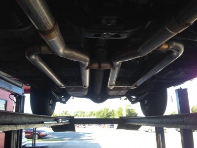

Like bigmanjbmoper said, I added 25" glass packs between the axle and tail-pipe. Problem solved.
Sounds absolutely perfect now.

These pipes should be tipped forward to allow Condensate to drain. Can you post another picture?
Excellent point on condensation...
