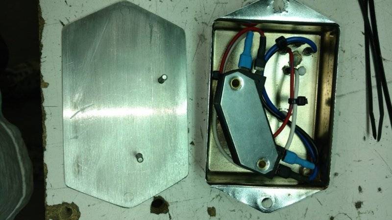

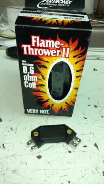

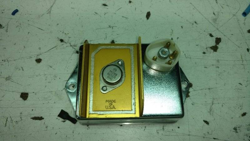

Curious minds want to know the answer. (or nosy a personI bought a Pertronix 6ohm coil and an AC Delco ignition module and going to try this upgrade. I have already gutted an old Mopar style Echlin ignition module to hide the GM module in. The car is a mostly stock '66 Coronet with a 383. Next month I'll take the car to the track to get a baseline on performance then go back after the upgrade to see if there is a improvement.
