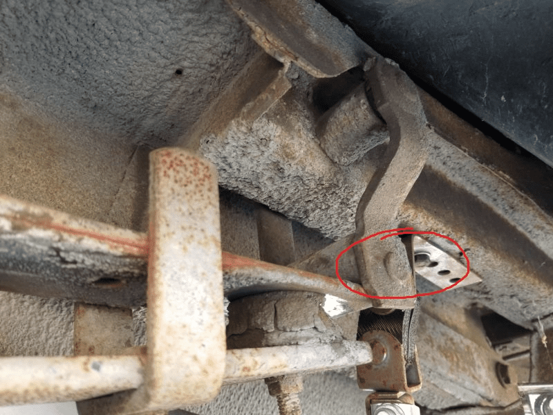

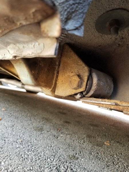

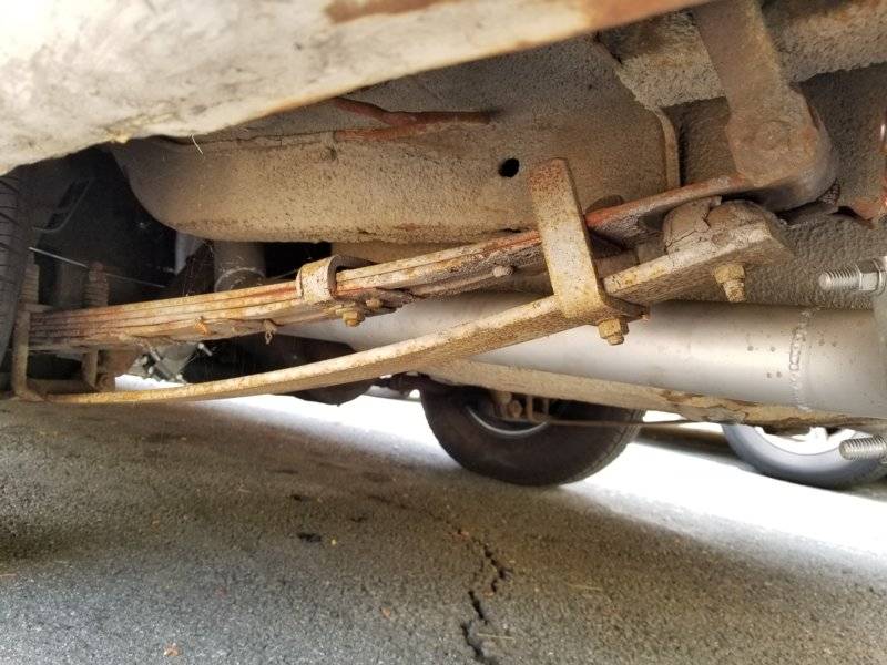

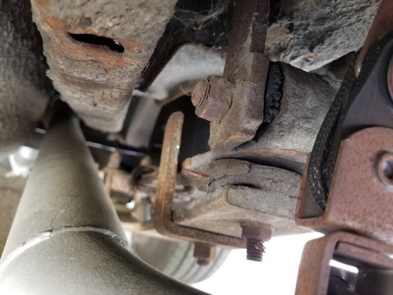

The first 3 pics are drivers side. The last pic is passenger side. They both look the same pretty much. I forget which side does it but I think it's when I turn right sharply 15557023542418993786834105212046.jpg
Are those helper springs or something, for extra weight or towing?
Helper springs, worn bushings, etc. If you plan on keeping and driving it, I would replace the rear springs and shackles. Good springs would eliminate the need for the helper springs and eliminate at least half your problems.

Definitely bearing are a suspect area. Just looking at the condition of the suspension back there I'm going with springs and bushings. On my 56 Desoto Wagon the drums were pulled for the first time in 2012 for brakes. The axle bearings were as good as the day they were installed.
Your springs bushes are absolute toast...
The pin or bolt is not even centered...rubber has disintegrated. Replace the spring bushes and you should be good.
Axle bearing growl not pop, MO. That spring and rubber parts are shot.

i think Kiwi has a Great Eye and has spotted your problem already.
i was so busy looking at all the other bushings i didnt even see what is clearly in sight.

Thanks everyone for the replies. I think it's dead on. I need to replaced all the rear spring hardware/bushings.
Good to know about the helper springs. Didn't even know what those were. Did someone likely put them on because the springs were worn out and sagging?
Yes, or heavy loads.
