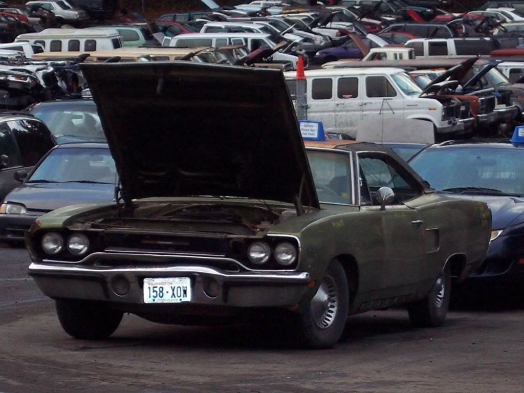

3 Years ago today, I brought home my Baby:
Since then, Life has been tough. And it's hard to get through the day sometimes.
