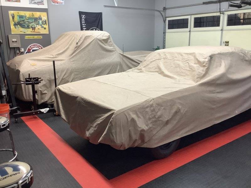

Mine went into my storage building in Nov. Unhook the neg cable , make sure the vents are shut, put the cover on.
Today I pulled the cover and fired it up for awhile, backed it outside and let it run up to temp. Pulled it back in and put her to bed till spring.
Worst thing you can do.
Now you've filled your exhaust system with moisture that's going to condense and prematurely rot out your exhaust system.
If you insist on starting your vehicle every few weeks or so, take it out and drive it far enough to purge the condensation from your exhaust system.

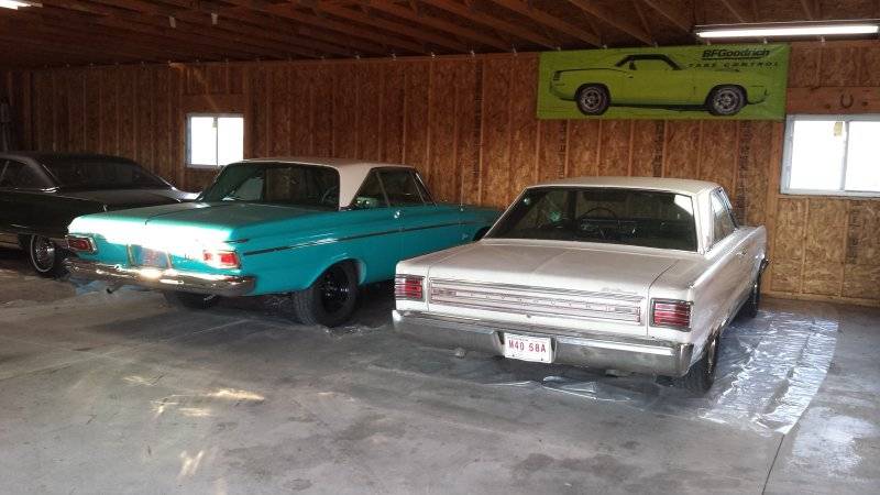

Mine sits in an unheated building parked on plastic. I put Stabil in the gas tank and have the tank full, then I pour a little ATF down the carbs while it's running to fog it. Then off for the duration of the endless salty WI winter. No cover. I flip the sun visors down in case a mouse would get in. It smokes for a few miles in the spring, but no issues, otherwise.

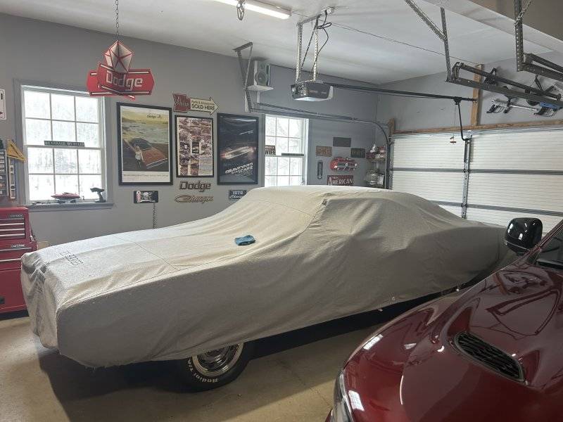

Fred used to wear a cover (he has a nice one) but it sort of leaves a funk on him come spring.
The last few winters, he's sitting in our unheated (but insulated and sturdy) garage next to the wife's
daily 2012 Charger R/T, so her door is open twice a day as she comes and goes...
I don't do much to Fred for storage other than close everything up, disconnect the battery and hook
up the Battery Tender, which does a wonderful job of keeping his big ol' 27 series battery topped up.
Oh...and @1 Wild R/T d ? Fred got out today, on a rare February day that set records with a high of 73.
Fired him up, gave him a quick dust off and off to town for some fresh alky-free high test.
For his part, he acted like we had just driven him yesterday...
Tough ol' buzzard, that Fred. :)
