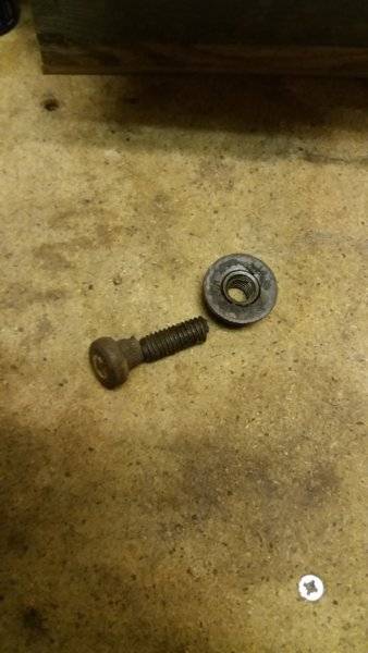

Hi,
slowly redoing the udnerside of my 67 Charger. When taking off the rear leaf spring hangers one of the studs sheared off, see pic. Any idea where I can get one? Yes, I know, I could just stick through a bolt and weld it to the hanger, but want to do it as correctly as possible.
Are those things called anything else but "knurled stud" or "knurled stud bolt"?
Greets
Flo
F
That’s the correct stud for the leaf spring hanger.
Try Mancini.
Go with bolts,bigger washers and lock nuts, it's complete safe. The only reason they used those studs where a faster mounting on the assambly line. (seconds=money)
That's the right bolt for the hanger. Pm me with your name and address and i'll send you one.
