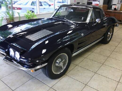

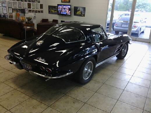

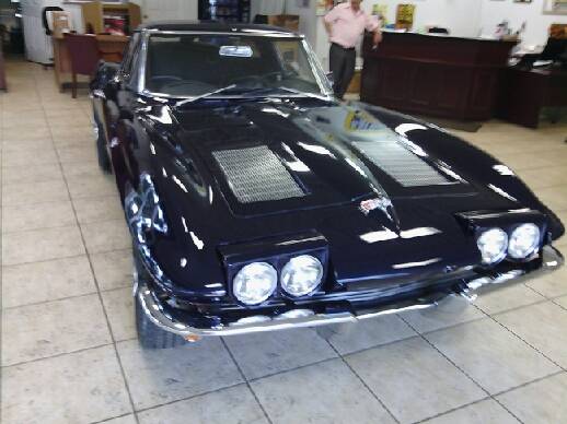

this vette was an old lacquer job with a giant scrape down the side...…… I buffed the good side, hood, rear deck, and roof; and painted the bad side with modern base/clear (driver side). I even pulled off an awesome clear coat blend at the top and rear end of the quarter, and top of the fender (along the body line) where I needed to. The damaged side was painted over after sanding with 600, there was a primer stripe about 4 inches wide down the side where the damage was..... your biggest problem is finding someone who can handle it.
