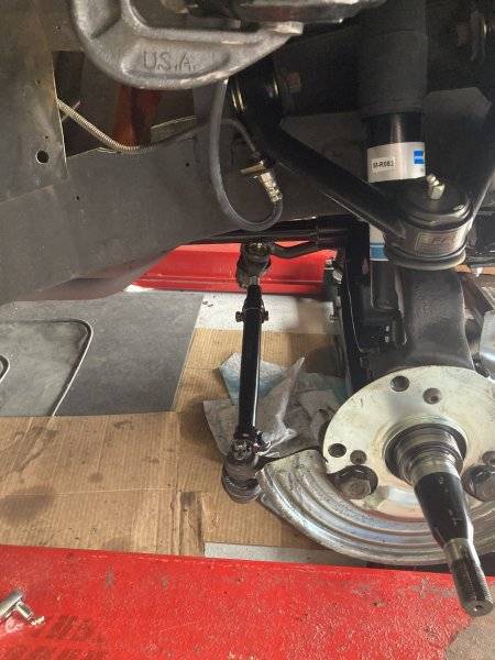

I put in a Borgeson box and related parts from Bergman Autocraft. He is a vendor listed on here. His customer service is excellent. The steering is very similar to a late model. NO play at all. I found out my Moog idler arm from 20 years ago has slop ! Got to change it to a roller bearing from firm feel or Bergman. The Bergman kit is more $, but I feel worth it !!!
