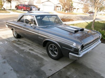

What is the largest width and offset anyone is running up front?
I've got 245-60-15 with a 4 inch backspace up front.
Here ya go....
15x7 front with 4 inch backspace 245-60-15
15x8 rear with 4 inch backspace 275-60-15
The rear has been narrowed 1 inch per side cause I used the housing from a 68 charger, but most guys use a 15x8 with 4.5 inch back space for the rear.
