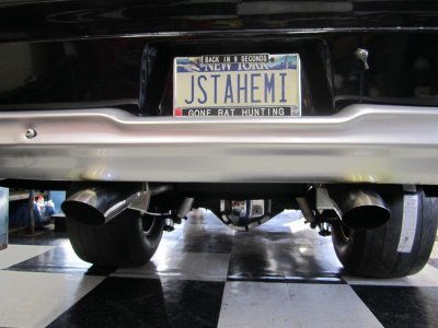

If you find that tire not large enough and need to go larger,my 63 Plymouth has the springs moved in with the mini-tub and my street meats are 16.5 X 31 ET Streets.:icon_thumright:

Thanks for the pictures and info. Hemicbx- I like the white wheels, very nice. I would like to have 10" wheel with 5 1/2" BS and 295/50/15. Do you think this would be better with 8" wheels? I was thinking with the springs relocated I could get by with more BS.( meaning back space :). Hemi-itis, love the look with the mini tub, just trying to dance around that!!
