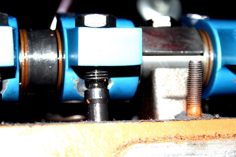

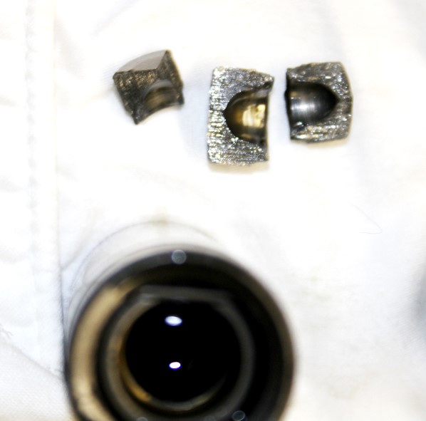

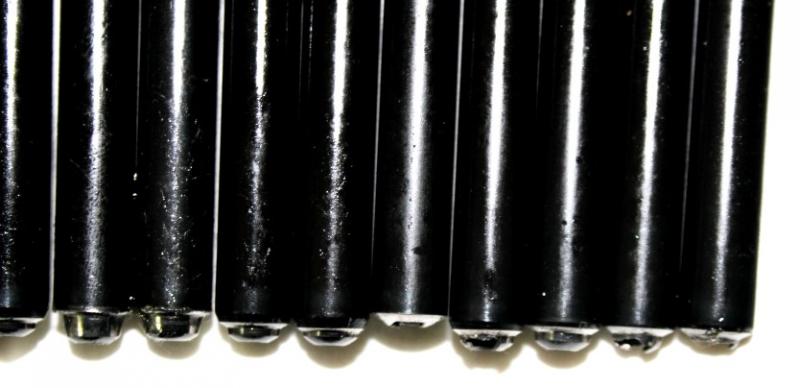

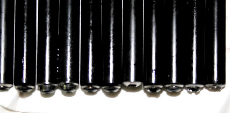

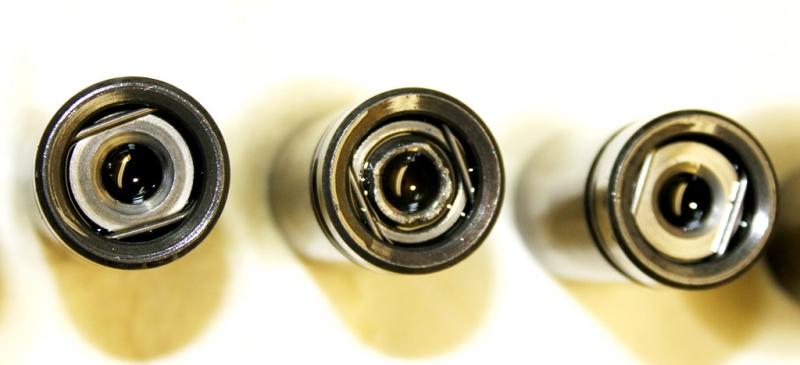

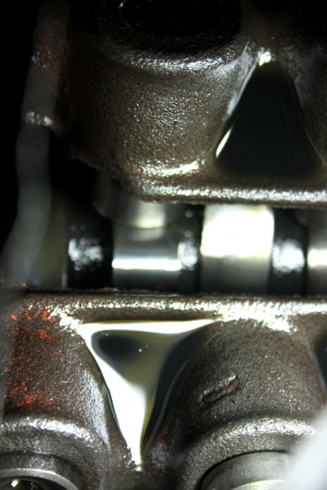

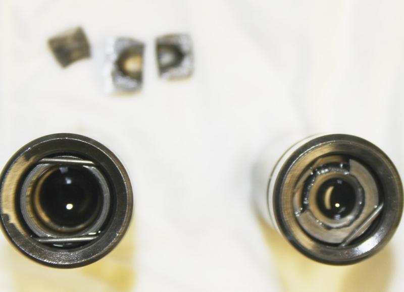

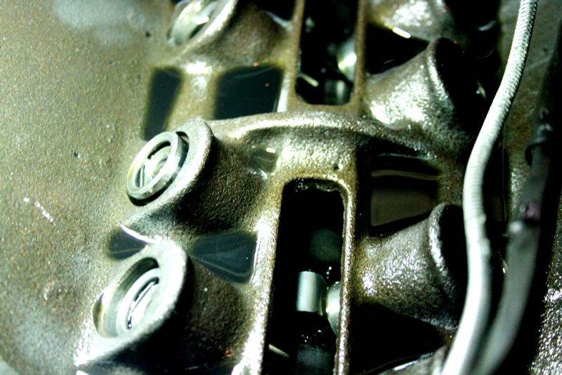

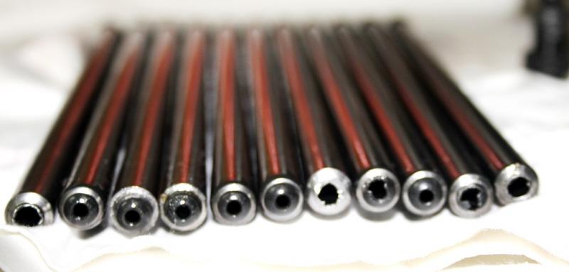

I had a detailed reply on how I followed what everyone helped me with and how I got to the point I am at now. This is a short version. When I went "go advanced" to put photos on, the forum went blank. So, here is what I found out:
The lifters are hydraulic, 5 of the 16 had a broken or shattered Plunger/valve. none of the pushrods were of the same length due to wear or breakage. The cam looks ok. When I miced the lobes and use the multiplier, I got .49 for both the exhaust and the intake. I think a .40/.49 Mopar is ok on this HP engine. Yes? Actual lift measurements varied, but within what I feel was in the margin of error due to the process I used of measuring it in place. The range was .3245 to .3275 with 3 out of 7 measurements being .3275. Worst was .3248. A lot, but then try to measure it in place with a depth micrometer over the engine casting. A couple of the lobes could be measured over and over and vary by .020. Others same every time. This was do to using the casting as a base for the micrometer to rest on.
I hate to think about taking the engine out to change the cam.
Question: Can I remove the cam from the front end (grill) of a '67 Satellite? Looks like it should all come off above the bumper and below the piece across the top by the top of the radiator.
I think I am going to buy the complete set from Comp Cam and let them pic the cam, lifters, springs, pushrods, timing chain and gears
(that seems to me to be the part I am not looking forward to). What about the balancer?
But, I am tempted to just replace the lifters and the rods and see what I get. If the worst cam is off by .025, wouldn't the zero lash adjustment take up for that?, or will it make too much of a difference in the opening of the valve. I really don't think it is off that much, but I have to call it like I see it. There is no more noticeable wear on it that the other lobes and no flat areas. Any other suggestions?

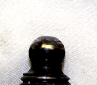

Here are some photos of what I found in my exploration. Thanks again to all who guided me and encouraged me to do this. Is this forum great, or what????
It is amazing that this engine ran as good as it did prior to parking it. There was actually no reason for me to want to adjust the valves except that I hadn't done it since I bought it last year, 400 miles ago. It never even made racket at ideal and the exhaust sounded nice. Maybe the headers and the 3 " exhaust hides a lot. Just wanted to add this.
