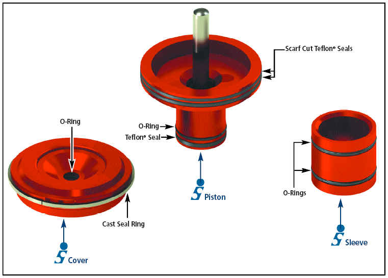

Slow 2-3 shift could be a restrictor installed in the case as part of the shift kit, too many springs in the front clutch drum, or fluid leakage past the seals for the front drum and/or front servo. A front servo kit like shown below fixes the front servo fluid leakage issue and firms up the shifts.
