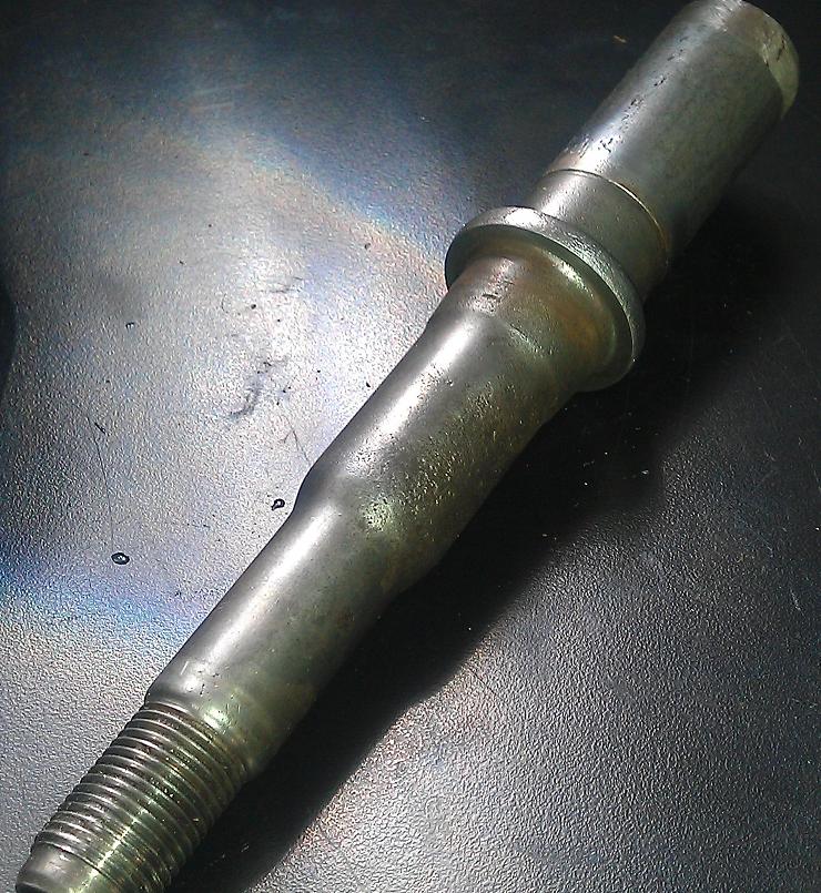

The shafts are somewhat pitted. Is this going to be an issue?
No , I do'nt think so. As long as the bushing fits tight on the shaft. You could also fill the pits if wanted for astetics. Mine looked alot like yours , and thier just fine.

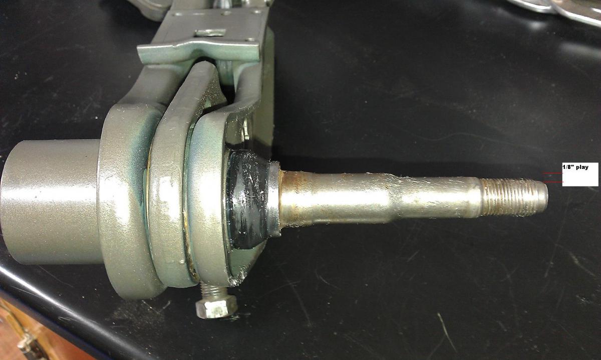

I just assembled the LCAs with the poly bushings. There is an 1/8 " play in the shaft/Torsion bar adjuster assembly. Is this common ???
So I should stay with rubber LCA bushings rather than the Poly????
The ones i took out are actually in good shape.
The LCA is still on the bench so this is an easy fix.
Poly vs Rubber LCA Bushings
Here's my 2 cents worth: Go back to the Rubber Bushings. Poly is over rated and they tend to squeak which will drive you CRAZY. 1/8" play will be a problem for you down the road.
Is the play in the bushing or in the LCA between the arm and the torsion bar reciever?If it is in the arm, once bolted in place, between the LCA pivot and the front strut rod, the play won't be there. If you use the poly/nylon LCA bushings just be aware of the issue with toe in adjustment, check the link I listed above.
I went back to the rubber bushing. The ones i removed were in excelent shape. Previous owner must have redone not too long ago. The play is in the whole assembly which includes the torsion bar receiver/torsion bar adj. lever/ piviot shaft. No play between piviot shaft and bushing.
