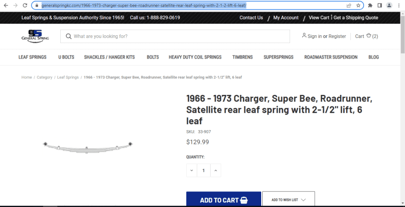

Hi I want to get new leaf springs for my 73 satellite to give it more lift. I live in the uk but have a friend who is importing a truck so want to bring them over in the back of that. I found these ones but was wondering if anyone's used them before and knows if they're good or if anyone has any recommendations for better ones?

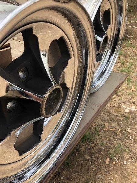

What are your tire/wheel sizes on those spiffy Keystones? I need to get a couple new ones, but they are out of stock everywhere. And even worse, their custom shop will not be opened back up until at least next summer.
What are your tire/wheel sizes on those spiffy Keystones? I need to get a couple new ones, but they are out of stock everywhere. And even worse, their custom shop will not be opened back up up at least next summer.
My spiffy keystones are 15x7 all around, 245/60/15 in the front, 255s in the back, they’re from 1984 and not quite as spiffy as they look in pictures, but the car isn’t perfect either so it works out. I wanted 15x8s or bigger with 275 or 295, but the eBay seller didn’t know how a tape measure works, or know how to read. They were listed at “15x8” oh well, he gave me $100 back. Keystones are my favorite wheel :thumbsup:
