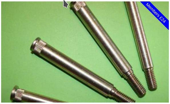

Looking for these (pic taken from British site, not for B-Bodies). I thought this would be a common-as-dirt, get-it-at-O'reilly's part, but apparently they are not so easily come by.
Nope, because OEM Mopar hangers come with them already attached to one hanger's bracket. I've never seen the pins sold separate.

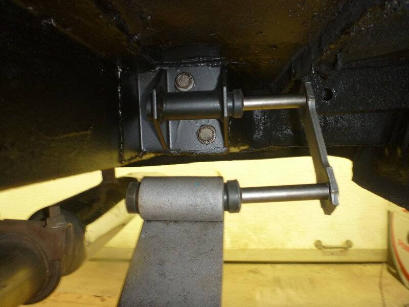

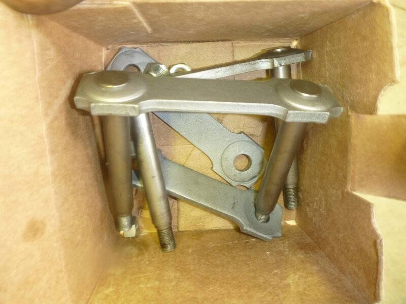

Our's are just like the ones in the pic I attached. After soaking my originals in vinegar to remove the rust, 1/2 of the pins fell out and the rest were easy to knock out. The sides are still good but half the threads on the pins are too far gone to reuse.
Just get complete new ones.
Looks like that's what I'm going to do.
They're available from most any jobber, you don't have to go the "restoration" company for them. I got mine from Parts Monkey for 30 canuck bucks.
