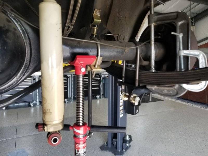

You will need post jacks to support the housing,or make some type of sling to hold the housing up. Remove the u-bolts,shockplate etc. Clamp springs together,remove center bolt.Do what you need to do at that point.Get some extra center bolts before you start.You may or may not need them.
Would the rear end not already be supported by the leaf springs now without adding post jacks? Thanks
Yes but you will have to lift the housing to remove the center bolt to dis-assemble the leaf pack.One jack would do.Or a ratchet strap in a pinch.

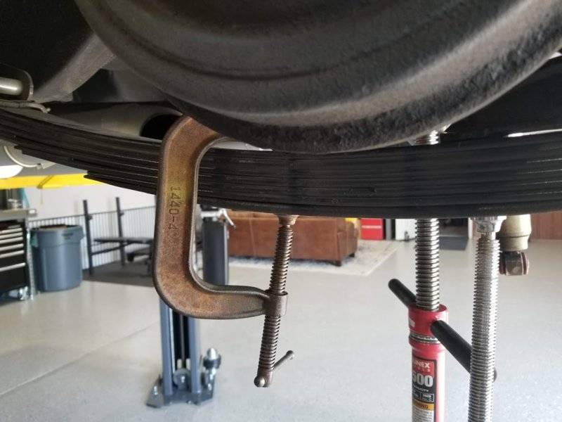

That worked great Darter6, went smooth and easy. I did have one tall adjustable jack, just did one at a time, worked great. Thanks!
Of course... had to use the 1 440 clamp. :)
