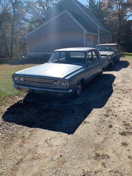

I bought my 65 Coronet already lowered by the previous owner. With stock suspension, wide tires and no sway bars it actually drives and handles pretty nice. A lot better than my wife's 65 Belvedere wagon behind it. I added front and rear sway bars and rebuilt the stock suspension on the wagon. The skinny stock tires are what my wife wanted so that has a lot to do with the handling.
I'm afraid to ad sway bars to the lowered Coronet. They might be too low. I'm already cautious going over speedbumps.
