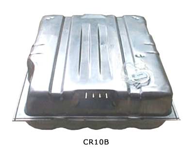

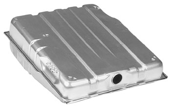

Thanks guys it has 4 vents on the side CR10B
I think you need the CR10A (side) tank not the CR10B (Front) tank.
My first pic is a front vent CR10B the second pic is a side vent it's # is CR10A
Look close at my pic's see where the tank straps would sit.
