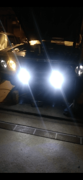

My headlights aren't halo but they have a side marker style socket so I put in a color shifting LED in them.
Bought them by bulk packs and they work just fine. I just put a dead end on those wires so they don't short out.
