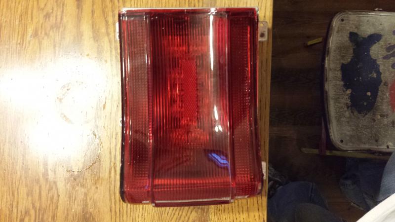

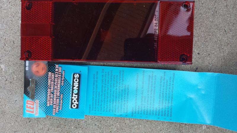

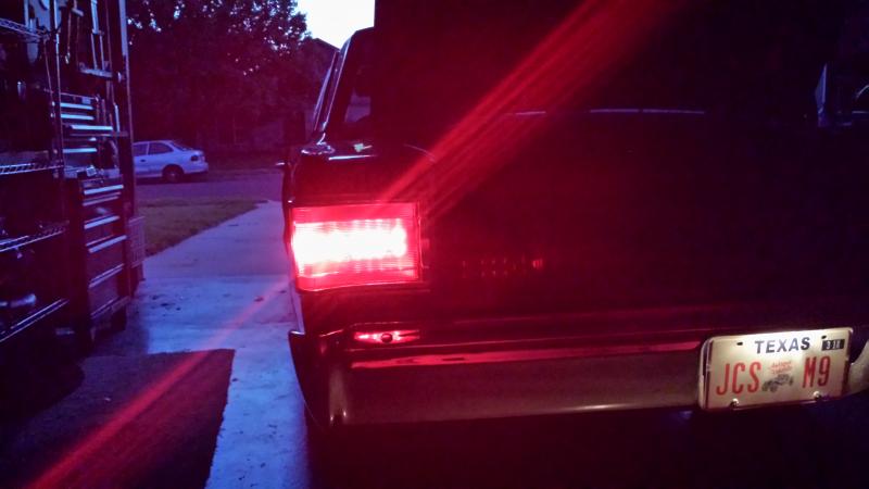

Just decided to try installing LED lights in my taillight housing using lights for trailers. Wiring pretty simple. 1 ground,1 marker, 1 stop/turn. pretty easy. The good thing is that it is reversible so if I ever decide to return, to stock I wont have any issues. 20140629_183648.jpg20140629_183705.jpg20140629_210618.jpg
Did the same on my 67 way brighter than stock What did you do about the turn signal did you have to change a flasher also? Or do those lights have something Built in.
still working on the other side, ill let you know.
I just used the LED bulbs in mine, signals work without any changes. I swapped all my dash bulbs out as well...wow nice clean white light. The only thing you need to use the old bulbs for your dash signal lights. I bought 10 1156 and 10 1157 and 8 dash bulbs for $18 bucks to my door from China...free shipping to boot.
AL
results. installed rear lights and everything works perfect. I have not changed the front marker lighst to led. I think the rear lights have variable load resistors built in them considering they are designed for trailers. Thanks for the reply's.
What brand are those? They look great and seem simple enough.
